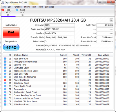

So far as I know, only the MPF and MPG model ranges were affected by the problem, which was caused by faulty MCU chips from Cirrus Logic. Big thread with info. It really was a huge problem, though -- something like 85% of the drives shipped were doomed within two years.
That said, I have an MPG3204AH model in my collection that somehow works 100%. It has the CL-SH8671-450E-A3 MCU and was manufactured in July of 2001. The SMART status shows as "bad" in some HDD tools due to a firmware timer in these older Fujitsu drives that trips up after a large number of power-on hours, but it works perfectly otherwise (no bad sectors, strange noises, etc). Naturally I wouldn't actually use it in a system, though.

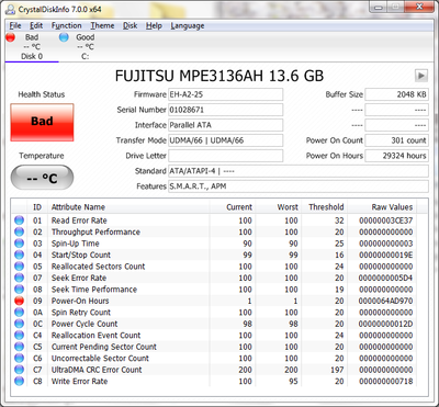

The other model ranges predating MPF and MPG are fine. My PIII box runs an MPE3136AH with no problems, despite nearly 30K power-on hours. This MPE family and previous use MCUs developed in-house by Fujitsu itself.
110.22 KiB
200 views
I have a couple others on the shelf that are also working normally (MPD3064AT, M1636TAU). I just wish there was a way to reset the "bad" status for the power-on hours count.
