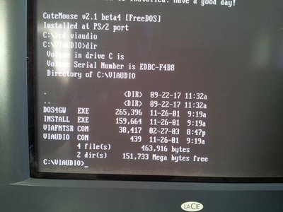

^^ everything needed to make it work.
The only thing you need to add in the AUTOEXEC.BAT is VIAUDIO.COM and VIAFMTSR.COM (in order), and then your SET BLASTER line:

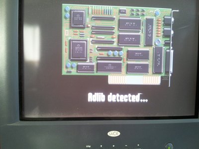

It even plays sound in stuff it has no business getting sound out of:
150.01 KiB
8386 views
Fans of Surprise! Productions's Copper demo will appreciate how hard it is to see this screen on this notoriously picky prod. It doesn't even work on my 386DX with a REAL OPL3 sound card. It seems perfectly happy with the VIA FM emulation though.

Ah, the good old copper demo! 😁 I used to entertain our family and
some acquaintances by running it on a 286-12 with a SB 2.0 and an ET-3000.
What I found to be kinda funny is that the "AdLib detected..." screen never showed an actual AdLib card
but some imaginary Sound Blaster model instead (that's not supposed to be something like a Sound Master II, is it ?)

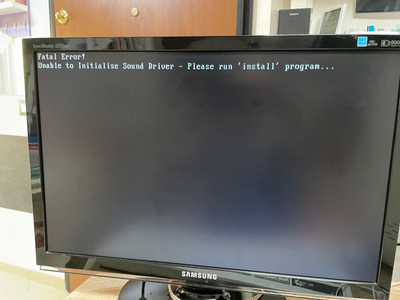

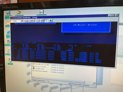

Reply 8 of 24, by punto2021
Hi everybody!
So, I've a beauty Pentium 3 with VIA Apollo Pro 133A. It is very satisfing, it managed to get me back to the 90s when I was just a teenager, I'm in love.
But now let's go to the problem: the audio on DOS games. I'm tring to run Descent 2 and Super Street fighter 2 turbo.
I've folowed this guide, my autoexec.bat include both VIA commands.
If I run the setup on windows 98 I obtain the error in attachement "d2", for both games.
If I run the setup on dos (F8 on boot and than command prompt) it detect the sound card and also test works fine! BUT starting the game descent2 don't show the video (graphic card issue I think) and ssf2t show the "audio driver" issue in attachement ssf2t.jpg.
There is anything that I can do?
Thanks!

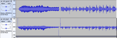

Well, my issue with Monkey Island 2 and VIAFMTSR looks definitely software.
Since I didn't know if the crappy rendition was actually a VIAFMTSR issue or a T5710 issue (like yet another cap gone bad), I was trying the only game I own from the ones recorded by xjas above: DUKE3D.
But to my surprise I noticed that simply running DUKE3D fixes VIAFMTSR!
I mean, compare this recording of the MI2 intro done right after a fresh boot: (WARNING: horrible)
mi2_bad.m4a
721.45 KiB
89 downloads
With another recording of the same MI2 intro done after having run DUKE3D:
mi2_good.m4a
720.95 KiB
87 downloads
I didn't change anything in-between, didn't touch the recording equipment, didn't touch volume/mixer controls, didn't restart VIAFMTSR, didn't reset the card using VIASBCFG.
if you look at the "bad" rendition's waveform, it's just strangely deformed. There has to be something going on in the tone generation / viafmtsr side, I don't think even you can cause this type of distortion with mixer settings.
44.87 KiB
4312 views
However reloading viafmtsr doesn't "break" it again.
Reloading viasbcfg does not break it again either, however a warm reboot (ctrl alt del) does.
Until I run duke3d again, that is. Which I guess I'm going to put on autoexec.bat 😀
No clue yet, but at least I'm happy it's not yet another hardware issue...
Reply 17 of 24, by javispedro1
Okey I think I figured out the cause.
Looks like the problem is whether the virtual SBPro mixer is set to mono or stereo output.
When duke3d initializes it to stereo, viafmtsr sounds OK.
And viceversa: setting it to mono causes the horrible FM. (it is not enough to change the setting in the setup program ,you have to at least Test Sound FX to make it re-initialize the virtual SB Pro ).
I may write a test program that just sets the corresponding bit in the mixer to verify if that's enough.
Duh I forgot about debug.com .
Assuming blaster is at 0x220,
debug
-o 224 e
-o 225 33
-q
This enables stereo mode in the mixer and fixes the issue with MI2 FM.
Still , it's kind of a mystery. I don't think the hardware is supposed to be initialized to stereo by default like that, so why would viafmtsr _require_ it ?
Maybe on computers with proper SBPro emulation support in the BIOS (sans VIASBCFG) it is initialized to stereo mode ?
