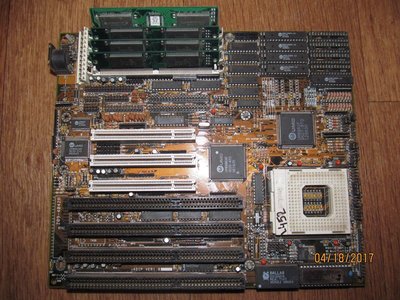

Hello All,
New to the group. I have learned A LOT after stumbling across this forum so thanks to all that have contributed. So, recently had the urge to play around with some older PCs from back in my younger years... A nerds mid-life crisis? Anyway....
I have a 486 board and have had a hell of a time figuring out the vendor and model. It boots and I'm trying to decide on what hard drive to use and it I want to mess around with an overlay. It currently boots to with an AMD 5x86 clocked at 150 with a heatsink and fan and 128 MB of RAM (overkill I know but I did it because I could) Also has a 4MB Matrox PCI video card, SB Gold and a USB PCI car (not sure if it'll work in Win 98 SE but we'll see). The markings on the board are TK8880F-4N-D63E and 4DIP VER 1.0, BIOS string is 2A4X5Z01C. I purchased it on ebay from the Ukraine and I've tried to check this guys site out chukaev.ru54.com/bios_cs_en.htm but it appears to be down. There are several boards that look very close to this one, the closest is a ADI F4DXP-UC5-1. Here is a pic
I'm wanting to make sure it has the latest BIOS version on it but according to this site: https://www.wimsbios.com/chipset/2A4X5.jsp - the string for the ADI board does not match. It currently has the same BIOS dated at the Shuttle (Holco) HOT-433. Some searches have pointed to it being a "Target" motherboard and ZIda. I saw the "Free Style" BIOS on WimBIOS' site but was afraid to try it. If someone could help identify this board and would be forever greatful

Reply 2 of 22, by Imperious
You are correct, it's almost impossible to find anything out there about this.
Most likely it will have a non flashable Eprom fitted. Even if it has a flashable one, unless You have an eprom programmer, leave it alone
or you might kill it.
I patched my 4DPS bios to support 40gig hdd, but as I have a programmer there is no risk. If you have a programmer upload the
bios here and I'll see if I can patch it with "Biospatcher" and "Modbin"

Reply 4 of 22, by TheMobRules
Ampera wrote:
non flashable EPROM
that's like saying un drinkable potable water
Actually the BIOS on most 486 motherboards is not stored on a flash ROM, instead they use UV-erasable EPROMs which are NOT a type of flash memory.
Only on certain (later) 486 boards you can flash the BIOS using the appropriate utility from AMI/Award/etc. , that's why Imperious suggests not messing with it unless using a programmer.
Reply 6 of 22, by feipoa
I suspect the BIOS from most PCI 486 motherboards containing UM8881F, UM8886AF, and UM8663AF chipsets will work on your board.
Your board is very similar to a Gigabyte GA486AM/S, however it looks like your board only supports up to 512K single-banked cache, while the GA486AM/S supports up to 1024K double-banked cache. This is merely a manifestation of the quantity of pins the manufacturer used on the cache DIP sockets and can be altered if desired, e.g. Re: The World's Fastest 486
Why are you looking for another BIOS? Boards with the UM8666BF were more likely to have BIOS updates. I'm still not sure what the difference between the AF and BF are, but I suspect the BF added PS/2 mouse support (I have zero evidence to back this up, just general observations).

Thank you that would be great. I do not have one but have been thinking about getting one.... I will let you know

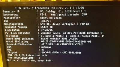

Reply 9 of 22, by spaceghost711
Update - Both Imperious and feipoa were correct. This board does have a "Non Flashable EPROM". There is a jumper when clearing CMOS and Programming the EPROM to use 5V or 12V. Feipoa was also correct, kinda. So I also have one of the infamous PC Chips 919 boards with the fake cache chips on it. So I pulled the BIOS out of it (AMI) and installed it on this mystery board (Award) and to my surprise it booted, count all 128MB of EDO RAM and gave me a CHECKSUM error. I entered the BIOS and fixed the clock and auto detected the HD as a 8GB instead of 2 GB which was one of the goals! But when I exited and saved changes it never came back so I had to put the old BIOS back in.
The BIOS out of the PC Chips board has been flashed with a BIOS version from 04/15/1996, the BIOS in the mystery board is dated -7/15/1995. I would just use the PC Chips board if I could find a COAST cache stick.
Another note, the PC Chips board os a BF chipset and the mystery board is a AF. I'm not sure of the difference either except that the BF had support for a PS/2 mouse.
I'll keep playing with it but thought this was an interesting outcome just switching an Award BIOS with an AMI BIOS from different boards with different chip sets and it did anything.
