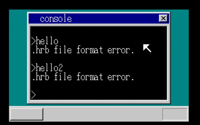

Just took a good look at popping SS:ESP from the stack when returning to an outer privilege level using RETF. It was using the incorrect layer to process it's POP for loading said data from the stack (internal instead of instruction level), thus always skipping the whole POPs of SS:ESP and leaving them zeroed. Whoops! 😖
Having fixed that, as well as related problems(CPL not being restored to it's old value when pausing the instruction flow(due to waiting for the BIU to read (E)SP and SS from the stack), thus aborting in the middle of the progress as well as said pauses causing (E)SP to be incremented multiple times instead of only once during said breaks(one addition for each break)), the applications run without crashing now! 😁
Various programs run without error now(except hello1 to hello3, which apparently give a wrong HRB file format error).
All other applications that are installed on the disk image seem to work without problems(although, when comparing to QEMU, the star demos actually execute so fast on QEMU that you don't see it(since it's closing the window almost immediately after drawing).
So simple but big progress there! All the apps(except hello and hello2, which apparently are invalid hrb files) seem to run without problems!

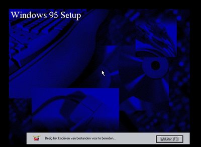

Copy files. Preparing...
144.41 KiB
1304 views
Windows 95 setup preparing to copy it's files.

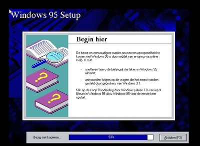

115.65 KiB
1301 views
More progress

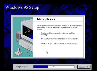

131.66 KiB
1301 views
Almost halfway

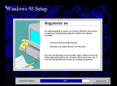

121.29 KiB
1298 views
More progressing slowly... 84%

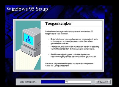

129.36 KiB
1297 views
Slosly but surely, getting closer to the finish... More than 12 hours later!
