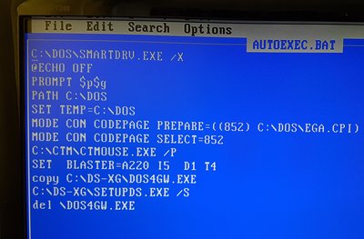

It does work (both OPL and SB emulation). Without TSR loaded, only Music works (and IRQs keep reseting after "/s" command alone […]
Without TSR loaded, only Music works (and IRQs keep reseting after "/s" command alone) 😒
With EMM386/DSDMA.EXE (and previous setting loaded from DS.ini), sound effects work as well.
If you have LOADTSR.BAT file it makes things easier.
However, if you try to run setupds after those are loaded... it will hard crash DOS (at least in my case).
Could you pleas post your autoexec lines for this card?
Reply 41 of 89, by agent_x007
1.97 MiB
2503 views
Remember about manually executing LOADTSR.BAT.
You can add it into autoexec if you want (it will hang DOS when you try to execute setup from yamaha driver).
Also, TSR requires EMM386.exe loaded in config.sys.
