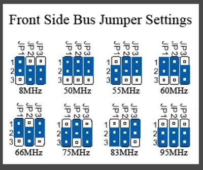

Ok, here we go - after some experimenting without any meaningful results, I had a second look at the manual (downloaded from this thread) to think of possible undocumented jumper combinations, and came across this:
54.94 KiB
791 views
It seemns @kanecvr was nice enough to add the jumper settings he found to the manual attached to this page!
If I would have taken the time to read his pots, I would have figured it out earlier. First setting in the pic witch I plucked from the LUCKY STAR 5v-1a Manual.pdf file in the first post clearly shows the "8mhz" jumper settings.
I tried the 8mhz setting myself but the PC would not post, so I read all of OP's posts. Turns out OP was using a pentium MMX, while I'm using a k6-2. I swapped my k6-2 for a 200Mhz pentium MMX and voila! When posting, bios says the CPU is a " " at 8MHz. Everything is SLOW!!! SOOOO SLOW! XT slow!

He-he… Is it same jumpers configuration for 8MHz and 60MHz FSB? Or what the difference?
Reply 22 of 29, by Horun

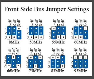

Hmm from the data sheet everything in jumpers matches with 1-2 =0, 2-3 =1. Except it should be 0-1-1 for Ref/2 (Ref is the 14.3Mhz xtal) for ~8Mhz like this

Reply 23 of 29, by Sphere478
Horun wrote on 2022-05-01, 18:22:
Goot catch.

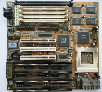

Can someone post a pic of the clock gen? And confirm that the datasheet posted earlier is correct? I’m assuming it is, just want to verify. I’m thinking of trying to order some of these for a experiment
Sphere's PCB projects.
Reply 24 of 29, by Horun
Sure ! See this one of the 5V-1A where it is very readable: https://www.ultimateretro.net/motherboard/ima … 11730668072.jpg
also found a picture of the 5V-2 which has ICS9169CJ-231 clock which does NOT have the REF/2 setting, instead it has two 75Mhz settings
https://pdf1.alldatasheet.net/datasheet-pdf/v … S9169C-231.html
added: the ICS9169C-23 (not 231 or -271) also has the REF/2 like -27 does....
