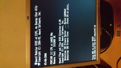

Hi.
It has bios dated 2000-08-09, which has been updated some years ago.
Its a via vt82c693a / 596b chip
Manual dated dec 99 states up to slot1 P3 733/133.
So the question is, would this card support any newer P3 cpus? If so which?
Thanks.
P.s
Forgot to mention that bios has settings for multiplier up to 10x anf fsb to 133
does it mea that it will support anything up to 1333mhz? A pentium 3 1333mhz slot 1 cpu?
