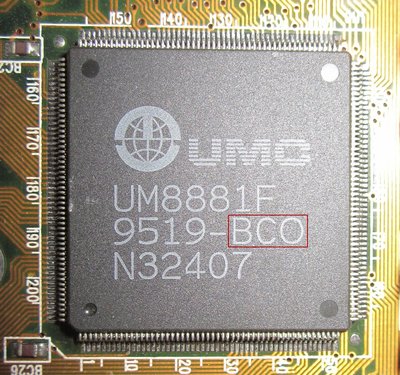

"Whether the VIP takes EDO RAM depends upon the version of the UM8881F fitted. There is a three letter code after the year/week code. If the FIRST letter of this code is 'E' then the board will take EDO. Other VIPs may have a 'B' code letter and it has been reported that during experiments with EDO and this chip version it doesn't work and the cache chips became extremely hot. Thanks to Ian for this tip."

Reply 29 of 56, by amadeus777999
It may be a faulty comparison but on my HOT433 board the 8881 ... -BCO version has been running fine with EDO.
I have also run into this, but was unable to draw any general conclusions. For a particular set of sticks of RAM I tried at one point, a certain EDO module seemed to work best on my unreliable HOT-433 boards, while other EDO sticks did not. The issue is that a lot of EDO tests on these 486 boards can initially seem reliable, until you start running stability tests, installing NT4, etc. In general, FPM tests have proven a lot more reliable on 486 boards. It seems like there is a very late model of the SiS 496 chipset which apparently works well with EDO. I think it is only found on some Lucky Star LS486 boards.
