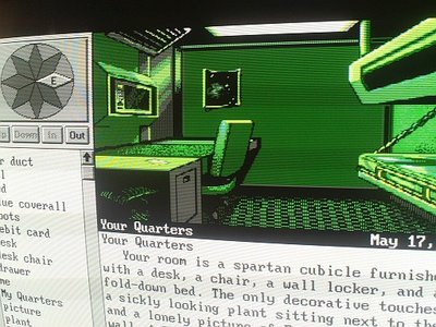

Reply 4 of 25, by Jo22
Thanks fellows, I solved it for now! ^_^
akula65, also thank you very, very much for that link about Multimedia Cloaking!
I'm just using a 286 PC here, but I'm fascinated by the article nevertheless.
If only more people knew about it, most of the memory issues back then would have gone away.
Anyway, I keep my eyes open for a copy of it. It could come in handy for that 386 I always wanted to build..
In the meantime, I'm using himem286.sys (1K) and mouse.com (4K) from PTS-DOS.
Both Windows /386 and Windows 3.10 do run fine with them so far.
And I can finally play Frederik Pohl's Gateway without getting a memory warning. Yay!
    91.01 KiB
    4197 views
    Frederik Pohl's Gateway, with EGA, mouse and music
