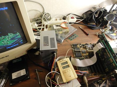

Here is a very non scinetific test. It's not like this thread is full of science so I guess it fits right in.
This is a 486 DX50 running at its rated speed looping PCP bench VGA mode. I guess PCP bench isn't a great CPU benchmark but the avarage game isn't either and PCP bench was the best (also only) loopable bench utility I happend to have on this DOS 8 start disk. As you notice the motherboard isn't in a case but on the other hand at least OEM systems tend to be designed so they have some airflow over the CPU area. On my "test bench" there is no airflow what so ever.
After looping PCP bench for about 45 minuts and seeing less than 0.5 degrees Celsius rise in temperature the last 15 minuts I took this picture. The CPU casing is probably a few degrees warmer than shown as only the tip of the probe is touching the CPU and the core is probably warmer than the CPU casing.
Even with the unscientific method in mind I would not be worried over running this Intel DX50 at it's rated speed bare in a case with at least some movement of air. This is coming from the guy that called out a former Vogoner (now living the "high life" on Youtube getting ad revenue, free hardware, nerd groupies and such) for running a DX4 bare in his Youtube show.
For anyone not understanding Celsius... the CPU is luk warm and using my finger as a probe I would guess the real temperature of the CPU casing is at most 5 degrees C over what the probe is reading.
1.44 MiB
686 views
An AMD DX33/40 is (like Scali already mentioned) probably running alot hotter than the Intel DX33 and even Intels DX33 could be running a bit hotter than this DX50 as it's made with an older process. I will test both an AMD and an Intel DX33 clocked at 40 MHz and report my findings.

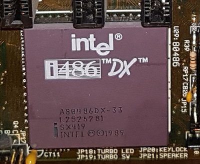

Reply 53 of 73, by Baoran
Not sure how that result can be so different. Basically my intel 486dx 33Mhz one would definitely burn my skin if I would hold my finger there and cpu load doesn't seem to change that much because it becomes that hot in just dos without running anything else.
Reply 54 of 73, by Scali
That sounds wrong. Are you sure you don't have a 3.3v CPU running at 5v?
Reply 55 of 73, by Baoran
As far as I know there is no 3.3V version of Intel 486dx-33
88.61 KiB
673 views
Because of it being so hot it could burn my finger, I did put that pentium heatsink + fan there just in case.
