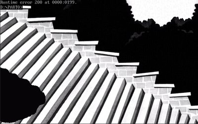

Hit and evaded every obstacle in trying to get it to work but this little commie game won't surrender without a fight.
JEMM solution (3rd link) solved the crash near the beginning but now it crashes just after the projector sequence starts (1 min). Every time at the same spot.
Btw, JEMM link (and the whole site) from that post is dead but I found a new one here.
Thing that crashes it is the "MIDI" sound option in the setup. Installer puts "sbmidi" in a single BAT file that's spat out on HDD. I think it's General MIDI but who knows. The only other available option for Music is "Adlib" which puts "adlibmsc" in BAT. This doesn't crash Intro but doesn't produce any MIDI music either so the only option is MIDI/sbmidi. Game uses a mix of CDA and MIDI music, separate to each screen. First time MIDI is used in the Intro is in the arcades screen.
Besides the Intro game behaves normal, if you don't count DOSBox 0.74 (+JEMMEX) crash upon exiting the game. Same type of errors as bellow, but that doesn't bother me. In SVN (ems=emm386) game exits cleanly. Played with blocksize/prebuffer values but it only felt like tapping in the dark. No idea if the game itself is borked or if its weirdo startup sequence, calling 4 EXEs, is a too much for DOSBox.
Here are some crash messages I collected using two DOSBox versions: 0.74, and official SVN r4063. Dunno if they help.
Sometimes the error messages showed, sometimes not. At least two runs were needed in each to produce 1st error.
SVN behaved much better, no error pop-ups just that cryptic looking message. The D:\PART0 is folder on the CD tho.
0.74 (with "JEMMEX NOEMS LOAD" trick)

SVN r4063 (with "ems=emm386" trick)
[attachement, message is identical every time]
    102.93 KiB
    2647 views

Reply 1 of 19, by ripsaw8080
Rank DOSBox Author
DOSBox Author
Runtime error 200 at XXXX:XXXX is a typical Borland error message for a divide exception. It is often caused by the CPU being too fast, so using limited or fixed cycles in DOSBox may avoid the problem. Alternatively, there are patch programs that can modify the problematic code to make it less susceptible, such as TPPATCH.

Reply 7 of 19, by robertmo
It looks the floppy version works ok.
But the cd version doesn't.
I guess SirGraham might have also been using a floppy version cause he says something about copying files to hdd image. The CD version installer only creates tbra.bat file on hdd and doesn't copy any files. So I guess SirGraham had floppy version copied to a CD for easier handling.
btw - edited my post and corrected "ems=emm386"
Reply 8 of 19, by robertmo
I figured out I already fixed my floppy version.
It appears there is some music initialization problem with Potiomky.msc
I have hex edited first line 00 C0 -> C0 00 (to much other music files) and it is i think ok now.

Reply 9 of 19, by Nilex
Hex-hax did it!
Very good catch. Compared the file to the rest of .MSCs and all the other (that I looked) had C0 00 byte order.
Same file is also in PART1&2 folders (CD version) with 00 C0 order. Made a note about em in case those Parts
also have their own Intros, and they crash too. What an Italian job this game is...
Thank you a lot for this. I gotta ask, how did you first solve it: knowledge, experience, luck, brute force?
