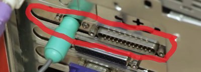

is there such thing as bracket for rear pc case to have a ps/2 mouse and 25-pin serial with each having the own internal header
or an internal header that already has a ps/2 mouse port and 25-pin serial port
the reason is because in one my rigs, a ps/2 mouse can be used but it not a standard din socket (more a header for a pci bracket) but no more free solts in back of case and i have a 25-serial port is on it own backet and wondering is i can combie the two on one backet
pic below in red circle is what I meaning

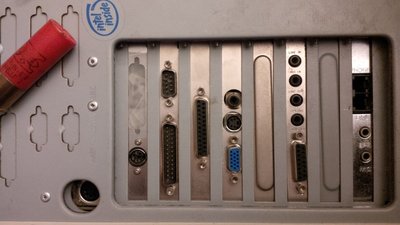

This looks like a job for a Dremel, a bag of jackstands, hex nuts, and screws. I've got a Pentium system that has such a combination, as depicted here (with the serial port opening taped over). Not sure how to get more, since the search terms would be a nightmare on ebay. Also I'd change my avatar but quick if I were you.

Reply 2 of 7, by yawetaG
You could knock out one of the serial port coverings in the case itself (like the ones shown at the left of Mister Xiado's picture), wire up a 9 pin DB9 port specifically for the PS/2 header and a specific serial -> PS/2 converter, and simply label it as "PS/2"

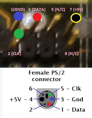

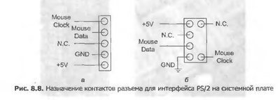

the header on my mobo is 6 pin shaped like an upside down capital U with 4 pins in top row and 1 pin on left and right side under the 4 pins
and maybe just like bracket with the ps2 port and hole for parallel port or serial, so I can still use those ports that is already in my p133 rig
right side in pic two is the pinout on my mobo (what it looks like)
    53.01 KiB
    1385 views
