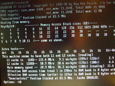

Interesting thread. I have a DEC system running a POD83 with 11mb of ram and 128kb of L2 cache. I had to buy the sram from Mouser a couple years ago because the mainboard didn't have any installed. I have a service manual from 1996 stating the L2 cache runs in wb mode but I can not confirm this. I've run Cachechk7 but it does not report if the L2 cache ram is running in wb or wt.

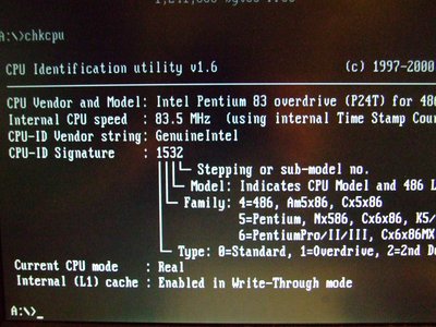

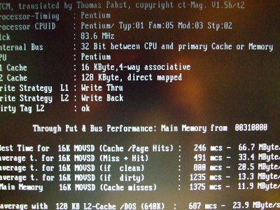

Reply 27 of 35, by bbhaag
feipoa wrote:
Could you attached a screenshot of what CTCM, CTCM7, cachechk7, and CHKCPU16 show?
I can upload pics from ctcm, cachechk7, and chkcpu16. I do not believe they will assist you in your search though. It appears on my mainboard the cpu operates in write-through mode. I apologize for the substandard pictures. They were the best I could take with my inadequate camera.

Reply 28 of 35, by feipoa
bbhaag wrote:
So far using the programs listed in this thread I have been unsuccessful in determining what mode the cpu cache is running in. Also the service manual I have does not detail this either.
The photos you provided indicate that your Pentium Overdrive is operating in Write-Through mode. I'm not sure why you said you were uanble to determine this in your previous message.
