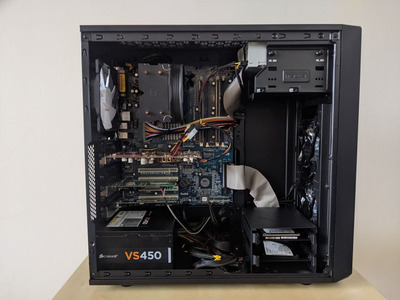

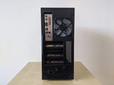

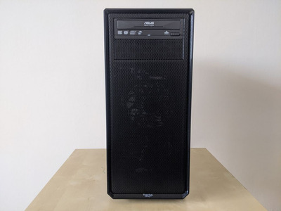

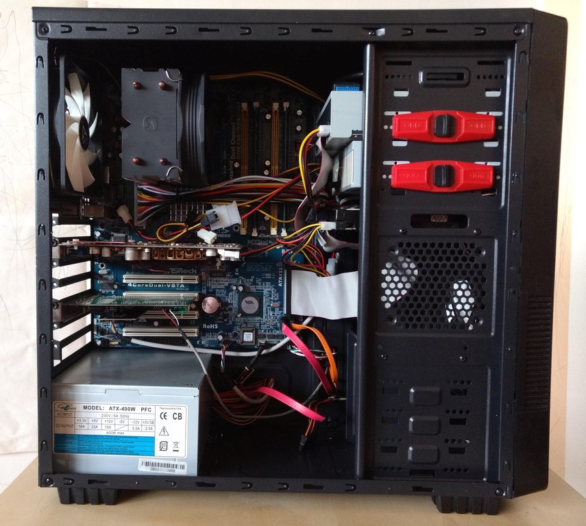

I would like you present my first ever “retro” build. Why “retro” in quotes? Well, it’s not really period correct, but it’s compatible with systems, which I wanted to be from the beginning of the build.
So, what’s the specs?
MTB: ASRock 4CoreDual-VSTA
CPU: Intel Pentium E6500K
COOLER: SilentiumPC Spartan 3 LT
RAM: 4GB (2x2GB) OCZ PC2-8000 DDR2 Platinum XTC
GPU: Radeon 9500@9700 AGP (perfectly working in Win 98, working with HDMI monitors without issues), Radeon X800 Pro VIVO@XT AGP (one of the fastest ATI card with Win 98 support, but if you use it with HDMI monitor, you won't get POST and OS loading screen), Voodoo4 4500 AGP (for Glide games), Radeon HD4850 PCIe (fast card for XP gaming)
HDD: Intel X25-E 32GB SSD SATA + WD 80GB IDE
SC: ESS Solo-1 + Dreamblaster X2
NIC: Realtek RTL8169 1GbE
DVD: ASUS DRW-1814BL IDE DVD-RW
PSU: Corsair VS450
CASE: Fractal Design Focus G Black
So, the most important question probably is, why I build this machine, and why I used mentioned components?
Well, few months ago, for some strange nostalgic reason, I somehow found out, that I culpable miss whole AGP era. With my old PC, I used Voodoo 3 PCI, and after that I switched to laptop for some reasons. And when I came back and jump again to #PCMasterRace bandwagon with my new desktop, AGP was already long gone and PCIe was everywhere.
And then, few months ago I realized, that I have some leftover parts, and told myself, that it can be reused in some kind of a PC build. And then, I somehow end at Vogons in topic about LGA 775 Motherboards with AGP Slots. And that was the last straw, when I started looking for missing parts, and started building new machine.
I was also looking for some more resources on Vogons, and find topic Why 478 and not 775? In it, there was crucial information, which then shaped specs of the machine, since from that point I was determined, that my “retro” PC have to be running Windows 98, as well as Windows XP in dualboot. This give me some headaches and was the reason, why some parts are different then on beginning, and why it took me months instead of weeks to finish the build.
Since I had Pentium 4 HT 520 for LGA 775 socket, cooling solutions are cheap and widely available, and there are motherboards available with this socket and with AGP slots, decision about platform was easy. I started looking for motherboards with AGP slot on eBay, and then somehow I realized, why not go totally overkill, and I ordered C2Q Q6600, since its dirt cheap. I then found really nice ASRock ConRoe865PE, but auction went south really quickly. It ends with losing to a guy, who paid eye watering 121€ for that used motherboard. Sorry, but I didn’t pay that much even for my new board on my main Skylake machine, so I started to looking elsewhere. Next auction end up better for me, since I won ASRock 4CoreDual-SATA2 with 2GB DDR2 RAM and some CPU. Before this combo arrived, I received my GPU, which was ATi Radeon 9500, the proper one, with 128MB L-shaped RAM and 256-bit bus width, and with hope, that it could be unlocked to full 9700. Fortunately, I had a lucky pick with this one, as it turned out later. Once I received motherboard combo, I immediately changed CPU for Q6600 and put all of this to my new case, which was cheapest black case on market with few requirements from my side: with PSU at the bottom, possible cable management, front USB 2.0 ports and available external 5,25” and 3,5” positions. I installed also my old SATA DVD-RW drive and also smallest (80GB) HDD, which I found at home, which also use SATA interface. And this is the point, where build hit the roadblock, at least for a while. On my machine with mentioned configuration, I was simply unable to install Windows 98, no matter what I tried. It try to boot from CD, but couldn’t find drivers for drive. I didn’t find any legacy/IDE or whatever option to emulate old IDE on SATA, so at the end, I just went with another DVD-ROM, with IDE interface. Ok, fine, I booted CD, installer started, but eventually, I run out my luck again. At the final moments of installation, whole process just hangs, and didn’t finish. At this point, I just put whole build away for some time, because I was quite frustrated. But, fortunately, this didn’t took long, and in few weeks I was again browsing auctions, for some IDE HDD. And after few days, I bring home same 80GB WD drive, just with IDE interface. Finally, after few months of unsuccessful tries, I was greeted with good old plain green background, only this time in FullHD. I have older, proper LCD with 1600x1200 resolution, but for installation and configuration, I will stick to my main monitor.
And during this time, I also found, that with much faster X850, it wouldn’t be so easy. For some inexplicable reason, X850 is unable to send its video signal via DVI->HDMI adapter into HDMI monitor. And what’s even stranger, older 9500, with very similar GPU have no problem with that. On DVI, there’s no issue tho. Just want to mention this, since X850 it’s the fastest ATI card with Windows 98 support, but for whatever reason, it’s not working with HDMI via adapter. I will definitely use it tho, just with VGA or DVI on older monitor.
Also, once I will finish installation and configuration of machine, I will maybe insert dedicated sound card into this machine, since there is laying one Sound Blaster Live! Value for PCI on my table. And already, there is another CPU, which will replace current one on way, and also second HDD for the system.

So, this is story of my first “retro” PC. But since picture will say more than 1000 words, here you go, how it’s looking currently. Cable management isn’t my best (and with my current PC, there’s just no contest), but it’s a hell of a lot better, than what I remember was with my old PC back in the day.
And of course I will be updating this thread, how I’m continuing with build in future.

I feel that 775 is more suitable than 478 for reasons that it supports duo core, which could speed up when running some big software such as Eclipse, JDK,Visual Studio 2008, 3DS MAX, etc. Multithread has been applied to these apps.
For video card, it seems that Geforece7 with AGP slot is your friend. 9500 is the beginning level of supporting DirectX 9.0C, and it run slowly on DX9 games. To name just a few, Doom3, Quake4, Need for Speed Most Wanted, Command & Conquer 3.
For the legacy IDE mode, it should be in the BIOS SATA section.

Well, honestly, I didn't build this machine for any productive apps, only point was old games 😀 And since Win 98 doesn't support more than one core, any other cores could be utilized only in Win XP, which is only 2nd system in dual boot on this machine.
The thing regarding graphic card (or any other part in the system for that matter), I always aimed to possibility running Win 98 on that machine, and this limits available HW parts. All games, you mentioned can be played without any issues on my main modern system, without worrying about low FPS or lack of power. GeForce7 (at least officially) isn't supported on Win 98, and for the intended use, it's kind of pointless. Also, as mentioned in first post, I still do have much more powerful X800 and X850, but I'm not using it right now because of DVI->HDMI issue. And one another thing, I bought mentioned ATI cards, because they could be unlocked either by Softmod method (for 9500, successfully done) or by using BIOS from higher model (for X800Pro/X850Pro, not done yet, will do in future), which is fun, something not possible to do with today's cards, and I wanted to know, if I would be lucky in this kind of lottery 😀
That legacy SATA option does not exist in BIOS. I later found out, that this can be bypassed with using RAID option. But this is not something, what I want to do, and I already resolve this issue by using IDE drives (SATA drives are still usable without issues in Win XP).
Anyway, some news regarding build. I upgrade (?) CPU for Pentium E6500K. Yeah, it's not a quad core anymore, but Pentium is much higher clocked and even for this kind of build, quad core was unnecessary. Also, this Pentium is stone cold (65W vs 105W TDP) and its cheapest LGA775 CPU which has unlocked multiplier. Will try to overclock it in the future, but I'm also curious about underclocking, I'm eager to see, how the system will cope with that. Small note, if you want to change the multiplier either way on board used in my build (ASRock 4CoreDual-SATA2), you have to disable Intel SpeedStep technology in BIOS.
And last new addition to my build is Voodoo4 4500, only graphic card from 3dfx, which officially supports AGP 4x with 1,5V. Can't wait to try some games in Glide after more than a decade! I will not however use this card as main one in this system, it's too valuable for me to do that.

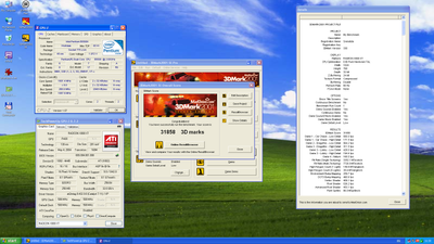

Ok, it's more then a year since last update, so lets make one.

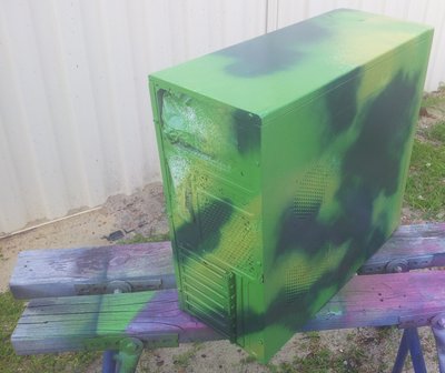

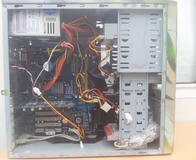

Reply 13 of 31, by bandicoot67
Very nice first retro overkill system you got there my friend! You know what they say around here right?, once bitten by the retro overkill build bug, you can never stop building them, ...ever!...don't worry though mate, it's not a bad virus to have. 😀
I've just put another one together with that same motherboard too. Initially i was going to accuse you of stealing my idea... 😜
I'll be posting a thread about my new win98SE build specs and paint job very soon.

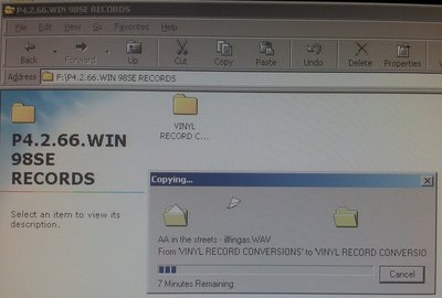

Can i ask you what the trick is with getting the stupid USB to work on this thing?..it's managed to out smart me.
Everything else is running fine now except the darn USB.
I've enabled USB in the bios. It sees FAT32 flash drives, asks for drivers, which i eventually hunt down, find on the net, install, re-boot and still nothing! 😒
It's driving me nuts man! ...what the phantom menace am i missing?

I had some issues with USB too. But following drivers worked for me.
Download VIA USB driver 2.60 and then install USB Mass Storage driver 3.6. After restart, you should be able to use USB flash drives. Please let me if it works for you too, thanks.

Reply 15 of 31, by bandicoot67
Awesome! That's the ticket right there. USB now 100% functional.
Thank you so much!
Got a minor problem with the ESS SOLO-1 sound card joystick gameport not working as yet, but i'll goof around with that later to see if a driver can fix it, or ill just swap it out for one of the other three i have here if worse comes to worse.
The only other two outstanding yellow exclamation marks in the device manager looking back at me now are; PCI Ethernet Controller and PCI Programmable Interrupt Controller, but the sound is working, which is all i really needed when i set up a SL1200 turntable for record conversions of some 12"'s i picked up six months ago. Only took 7 mins to copy 900mb's on a flash drive so...very happy face!

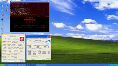

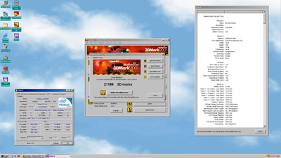

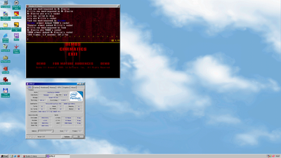

Anyway, I finally reflashed vBIOS on my Radeon X800 Pro VIVO to X800XT, which went flawlessly and I started testing it. And then I found out, that I'm complete tool, and that card works with HDMI monitor... Well, sort of... For some strange reason, when X800 is connected to HDMI monitor (with DVI=>HDMI adapter), I won't get neither POST, nor loading OS screen, but once OS is loaded, video signal is back and I can use the system normally. Very strange, since with DVI (and VGA as well for that matter) everything is as it should be, and DVI is converted to HDMI by passive adapter... Well, at least I can run twice as fast GPU as my previous Radeon 9500@9700.

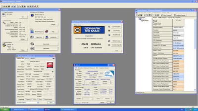

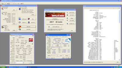

Also, since I have perfectly working dualboot to 98 and XP on that machine, I did some benchmarking and results are... Very interesting to say the least... I benchmarked 3DMark99MAX, 2000, 2001SE and Quake 3 Arena Demo. There were 2 issues, which I found during the testing, hopefully this helps someone in the future.

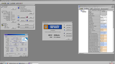

3DMark99MAX won't run under XP, I'll get error message about missing DirectX 6.1. Fortunately, fix is really easy, and you can find it here: Re: 3dmark99 MegaThread

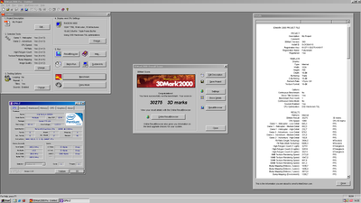

And I was unable to run 3DMark2000 under XP, which may be caused by dual core CPU, which I'm using. Fix was also really easy, just run it in Windows 98 compatibility mode.
Now for the promised results, enjoy.

Reply 18 of 31, by Srandista
And rest of benchmarks.
