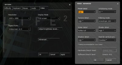

As mentioned in another topic, I tried to actually properly benchmark HL2 this time. And the results are not good for Win98.
This are graphics settings (really high, but I wanted to push it). I used timedemos from Anandtech with HL2 build 2187.

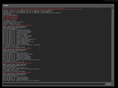

And these are the results for Win98...

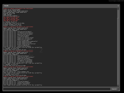

...and WinXP.
31.57 KiB
1569 views
Everything in machine HW wise was identical (current specs in OP, GPU for these tests was X800 XT), the only change is OS. Poor 98...

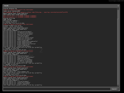

Reply 25 of 31, by Srandista
gdjacobs wrote on 2020-04-29, 00:37:
You're comparing single vs dual core in an SMP enabled title.
Well, I tried it with just one core active and results are... exactly the same...
32.15 KiB
1468 views
So HL2 is clearly optimized to Windows XP somehow. Just FYI, I used this guide to limit system to one core only and verified with CPU-Z that indeed only one core was active.
