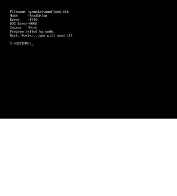

I have tried looking for another instance of my problem on the forums, but haven't had any luck. I am running Ultima 8 (both CD-ROM Hard Drive Edition and Ultima Collection behave the same). It plays fine, but sometimes when I save, the game flat out crashes. I had Munt installed, and had to uninstall it from my system since changing the midiconfig setting to 0 didn't work (the default setting, and Munt was using 1), and setting ems=true and umb=false also caused it to crash regularly. I am saving in different slots.
With my current settings, (and Munt uninstalled, ems=false and umb=true) it crashes much less, but I never had this problem before. When I don't have Munt installed, or have ems=true/umb=false set, sometimes the game save is just lost, but with Munt not installed, ems=false and umb-true, it will load the game save before I tried saving in that slot. My system specs are as follows:

I have included my current DOSBox cofig file, and a screenshot of the message generated when the game crashes. I don't know what else to provide, so if anyone needs more information, and knows what is the problem, I would deeply appreciate any help, and thank you in advance (and afterwards). I appreciate the time and trouble; I've been searching everywhere and haven't found a solution. Thank you!

DOS error 2 is "file not found", so check if the gamedat\nonfixed.dat file exists. If that file is indeed missing then I guess you'll need to re-install.
Also, maybe try increasing cycles, as I read a comment that the game tends to crash on save if cycles are too low.

I've never encountered this problem before; played it in regular DOS when it was released, and in DOSBox a couple of years ago, with no change to my system since then. There are two files in the GAMEDAT folder; one NONFIXED.DAT and one NONFIXED.$$$, so the file is definitely there. I can try increasing the cycles, but my system is slow enough that it will cause performance issues. I will try it and see what happens. Thanks to all who helped.
EDIT: I played for a brief spot at 12,000 cycles, running around Stone Cove collecting Necromancer reagents, and saved, not encountering the crash, but the sound did sputter as it sometimes does after saving, without noticeable performance issues. I will have to play longer to see if the higher cycles will fix the problem. Thank you again to all that responded and offered help.

Even at 12,000+ cycles, the game still crashes. The NONFIXED.DAT file is still there, and I don't know what else to do. I'm tempted to run it under DOSBox 0.73 as an experiment, though, I don't know what difference it will make. I'll just have to manage it the best I can, and thanks everyone again for your recommendations and suggestions.
