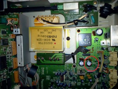

I have probably fried my 88pro US version.
I got one and I bought a converter from 220-110 to use it in europe.
hooked it up and it worked for 20 min before it began to smoke.
I immediately turned it off, dissasembled and saw that one capacitor had leaked a little and spraying some acid on the pcb above it.
the unit was quite warm in area of the capacitor.
Inspected the unit and could not see any damage neither any bad smell.
I noticed the 100v(soldered) 120v 230v 240v on the transformator.
I also found the thread about convertion of sc-88pro
so the question, did unit collapsed because of the 110v delivered and not the intended 100v?
May the unit have lived on 230(because of the possible faulty converter) for 20 min?
how much damage can it have received? any change that it has survived the accident?
is there any point in soldering over to 230 and trying it again?
attached the picture, the capacitor which leaked is the one marked red.
any help is appreciated.

There are also voltage converters that are meant for a bit heavier loads so it is possible your converter has put out significantly larger voltage to this low power load and the cap vented because of overvoltage. It looks like there is no other damage. It could have been due to old age as well, but seriously I'd check the converter.

Just replace the cap and the unit should be fine. It most likely just failed because of age.
110v vs. 100v should not be an issue.

the picture is borrowed so you cannot see the damaged cap as it is now, it has bulged just a little bit.
I have yet to check the underside of the pcb the cap it sitting on.
So you saying is that I may with no fear solder to 230 and try to fire it up?
or should the cap be replaced before doing anything else?
thanks.

Yes, you can also move the black wire from 100 to 240v to convert the unit to 230/240v. Did that in the past with several units. One big advantages of transformer-based PSUs.
The cap must be replaced first, however. You may want to replce the other big ones too, while you are at it anyway.

I think you misunderstood me. What I mean is that your converter is capable of powering high-power loads such as hairdryers and will give them the correct 110V voltage, but when you have a low power load like the SC-55 it might not convert the voltage down properly and give overvoltage to light loads. I don't know what kind of converter you have, that's why I asked you to make sure you have the correct kind of converter that will work correctly with low powered sensitive electronics, not a converter that works properly only with high powered hairdryers.
So don't use the converter unless you know it can be used with low power electronics, it might be the reason the cap blew up.

You must replace the cap and then you can move the wire from 110V to 230V or 240V whichever you think is best in your country.

The SC-88 has a linear power supply, so having a bit higher voltage is not fatal. The unregulated 5V supply has 16V capacitors and unregulated +/- 12V supplies have 25V capacitors, so those are the hard max peak voltage limits. And it will still work if unregulated 5V supply dips to 5.5V and unregulated 12V supply dips to 14V. There is no mention what the transformer output AC voltages are.

I've managed to replace the cap(s)(both 1000mf/25v and single 3300/16v) and also soldered over to 230v on the transformator to be able to use it directly in wall-outlet here in Norway.
