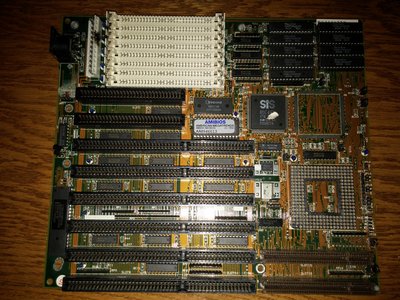

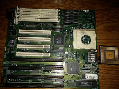

I'm not familiar at all with motherboards and CPUs from this era. These are the first boards from this era I have had in my possession. These boards need a couple repairs, but if I knew more about them it'd probably help.
What kind of CPU is that? How can I tell which boards it will work in and where it goes in the socket?
Does the cache on these boards look legit?
Also, the VLB board's crystal has partially lost its markings... I just see an "8" toward the end. What speed 486DX is this board likely meant for?
The CPU came in the green board with the ZIF socket, but I don't think it was installed in the correct orientation when I got it. Stupid me, I didn't realize this until after I tried to power it on. The little (VRM?) chip near the socket, with a heatsink, smelled "hot" but didn't smoke. Dumb move on my part, but I had no idea that the chip wasn't installed correctly, or that it was even possible to put them in wrong on a Socket 3 board. I don't want to mess with it any more until I know more about them. Is something likely to be dead because of this? CPU, VRM, etc...?
Any ideas as to make\model of these boards? I found a schematic for an old 386 board I got with these, and that has helped immensely. I can't figure out what brand these are though, so I haven't found anything about them online.
Also, I removed the NiCd batteries from them. I plan to purchase a bunch of 3xAAA battery packs and use low self discharge NiMH batteries for them, as those are easy to use and should last a very very long time. Is this a good idea? I'd use a button cell, but I'm not familiar with the changes that need to be done to prevent them from being charged (ruined) by the board.
Any help is much appreciated! I'm itching to test out some VLB cards and to set up a few systems to fill the huge gap between my IBM 5150 and the Socket 7 systems I have around.
EDIT: Just realized my flash washed out the markings between the ISA slots. It says in there: ASY 01-00232-___REV___ . All of the white spaces were left blank, even the S/N:____ space.
EDIT2: The burn mark on the AT power connector is from a nearby blown tantalum, and that cap will be replaced. Damage seems minimal.

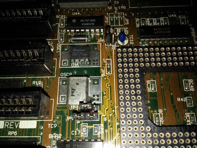

The second board looks damaged to me (there's a burn mark on the P8/P9 <-- AT PSU ports).
Reply 2 of 35, by Kubik
That crystal is most likely 14.31818 MHz, which is sort of a base frequency for PCs 😀 The chip next to it, made by Avasem, is a PLL clock generator that converts 14.31818 MHz to other PC frequencies - see http://pdf1.alldatasheet.com/datasheet-pdf/vi … ST/AV9107C.html
Reply 3 of 35, by Ozzuneoj

Yes, its actually a blown tantalum between the P8/P9 and the SIMM slots. When I bought the lot containing this board I thought it was fried but I was pleasantly surprised to see that it was just a tantalum scorch mark.
Reply 4 of 35, by Ampera
Welcome to 486s.
The first board is Socket 3, meaning (especially with the VRM there) it supports both 3.3v and 5v CPUs.
When installing the CPU into the Socket 3, line up the key on the CPU (it can be a dot on the corner, there may be a larger corner, or a line pointing to it underneath the CPU.) to the lone pin (here on the top left corner of the socket where the lever hooks on) on the socket. Like any ZIF socket, release the retention arm, pull it back, insert the CPU properly, and then close it.
Nearly all 486 boards are configured using jumpers, so you will have to look up what the jumper configuration on your board is for your CPU, as well as what you want the clock to run at (this is configured manually too). The speed the CPU should run at is always on the chip, normally obviously (DX4-100 is 100mhz, 33x3, DX40 is 40mhz 40x1, DX2-66 is 66mhz, 33x2).
BIOS support is usually needed, but you can often get away with using a chip that's not explicitly supported on your board by BIOS so long as the clock and voltage are correct.
ALL chips above 66mhz REQUIRE cooling. This comes in the form (usually) of a heatsink that clips directly onto the ceramic of the processor. Some can clip onto the socket, but they are normally board specific.
The second board is busted. A component (blue, forgot what it is) seems to have caught fire and torched the AT connector. You could replace it (as almost everything is through-hole here) with basic soldering/desoldering equipment, as long as you can figure out what part is was. (it appears to be identical to some next to it).
It appears to be Socket 2 style, as it lacks any obvious VRM onboard. This means only 5v CPUs, or the Pentium OverDrive, will work on it. If you wish to use newer 3.3v CPUs on the board, a VRM that sits in-between the socket and the chip is needed, but they aren't remarkably common.
This is a LIF socket (not ZIF). It stands for low insertion force and does what it says on the tin. In order to install a CPU, line up the key (as before, dot, larger corner, or line (on some CPUs)) to the corner of the socket that has the 3 missing pins, and very gently press it in. Do not force it, but it won't drop in like a ZIF socket. It's in when it reaches the bottom, there is no retention arm.
The cache is legit if you run a cache test and it says you have cache. PhilsComputerLab has a benchmark/utility disk for DOS that has what you need.
As for if anything broke, you could have fried the board, the CPU, or neither. It's hard to say unless you try it again proper, and/or with known good parts. I can't see what the CPU is, but when you try it on that board MAKE SURE THE VOLTAGE IS SET RIGHT. It won't automatically detect, you have to configure it manually as well.
Reply 5 of 35, by BeginnerGuy
Also,
Boards 1 and 2 look to have had their cmos batteries removed. If we google some identifiers on these boards we may be able to get a diagram of all the jumpers to learn a bit more about CPU support. Chances are the PCI board can run everything from the lowliest 486 on up to the AM5x86 133.
Board 2 doesn't look like it took too much damage, just replace that tantalum cap and give her a smoke test 😊 .
I can't tell what CPU you have there. Is the top covered in thermal compound or something? It should say what it is. On second glance it looks like it has a little heatsink attached, does that not just slide right off or is it glued on?
with board 1, all you'll need is some 70 pin FPM ram and a graphics card and it's good to go (aside from sound, networking, etc, etc). I see it has an integrated IDE controller (IDE and FDD headers right under the RAM).

Reply 14 of 35, by Ozzuneoj
I got a new TIP127 to replace the one that died on the green board pictured in the OP, I installed it and it actually turned out pretty decently (first chip of this type I've ever soldered). The board still doesn't POST, but at least the TIP127 didn't fry itself this time.
As it turns out, I only have EDO RAM in 72pin SIMMs, but this post at VOGONS shows a board running the same chipset with EDO:
A Tale of Two 486 Motherboards (ALi vs SIS)
I also haven't found the front panel pinouts for this board so I don't have a speaker connected yet.
Any help finding the pinouts for the board or suggestions as to what could be happening would be appreciated!
The only distinct markings on the board are at the top edge and say PCI48AF-3.00.
EDIT: Derp, nevermind, I had found it already, its the other one I haven't been able to find documentation for.
http://stason.org/TULARC/pc/motherboards/T/TM … AF-VER-3-0.html
Using this information, I've got a speaker connected. When there is no RAM inserted I get one long repeating beep: beeeep....... beeeep....... beeeep
With one or two 8MB sticks of EDO inserted, I get no beeps and no display with either an ISA or PCI VGA card.
I've checked all of the jumpers on the board and they all seem to be correct for this CPU and the amount of cache installed.
I'll keep trying things, but so far, I'm not sure what to think.
