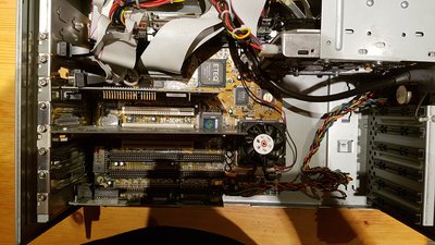

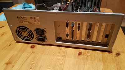

Reply 5 of 19, by Baoran
I just received the pc today. It seems I was mistaken about the motherboard. I only had a post screen picture from the seller that said EH-1BC1.
The motherboard is actually Soyo SY-5EHM. I found manual here http://www.motherboards.org/files/manuals/107/m5ehv1310.pdf
It seems that I won't be able to use 1.6V K2-III+ with this motherboardbecause voltage settings are only between 2.0V and 3.5V. Cpu that came with the pc seems to be K6-2 300Mhz
Here are some pictures.

Reply 6 of 19, by Baoran
One thing interesting that I noticed is that even though the motherboard seems to be baby-at size, it has both AT and ATX power connectors. First time I have seen that.
It also seems to have ati rage pro turbo graphics card in agp slot.
Anyone has any idea how to recognize what revision this motherboard is?

Reply 9 of 19, by Baoran
Yeah and when you touch it, the insert has made to feel rough and different from rest of the plastic on the case, so it almost feels like it isn't plastic.
The pc seems to be working fine. Hard drive had NT 4.0 that didn't boot because it said that there was a missing file, but when I installed dos 6.22, everything seems to work fine. The cpu fan sounds like it is going to need a replacement though.

Reply 13 of 19, by Baoran
I have actually no idea what revision the motherboard. I found manuals for REV 1.0 and REV 1.3, but neither is a match. It feels like it is even older than REV 1.0 because REV 1.0 has 5 switches for cpu voltage and this motherboard seems to have 6 jumpers instead of those switches.
Reply 15 of 19, by Baoran
After bit of searching, I found a third manual that seems to match. http://www.motherboards.org/files/manuals/107/m5eh20.pdf as it has those 6 jumpers in JP30 to set voltage for cpu.
