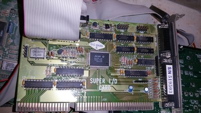

I got my hands on a sweet AMD 286-16Mhz pc. It came with an ISA "Super I/O Card" with an Acer M5105 A2 chip (picture attached), but without an HDD.
I added a WD Caviar 2200, 212.6 MB HDD, and configured it in the BIOS according to the writing on the disc - but every time I boot, I get an error message: "fixed disk controller failure". I need to press F1 to continue booting from floppy, or F2 to enter BIOS.
I am able to boot from a Gotek floppy emulator, and once I'm in DOS (MS-DOS 5, if it matters), I can access the HDD without any problems.
I've partitioned the disc with FDISK, formatted it, copied files, games etc. and all seems to work without a hitch. But even though I've formatted with /s and I can see the system files, it still shows the above message and won't boot from the HDD.
I tried each of the 2 connectors on the IDE cable, replaced the IDE cable altogether, changed the card slot.. but no success.
Any help is appreciated 😀

Did you tried "fdisk /mbr"?
Reply 2 of 12, by derSammler
"fixed disk controller failure" is something you normally get with IDE when the CHS parameters are incorrect. Are you sure you have entered them correctly in the BIOS? Should be 958/12/34.

I am positive that I entered the correct parameters. But according to the writing on the disc, its 989/12/35. I tried the parameters you wrote, but I still got the same error.

also, make sure the jumpers on the card are set correctly and the IDE is enabled, if not will display this error.
Reply 6 of 12, by alvaro84
Me experience with old WD caviars is that you should just remove the jumper to set it to master. No matter what the sticker says.

He can read the files on the HDD when booting from floppy. So IDE is surely enabled and jumpers are probably set correctly, too.

Dude! That worked!
I was sure (as others here) that since I can see the disk when booting from floppy, it is configured correctly.
Thank you very much.
