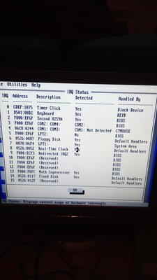

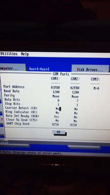

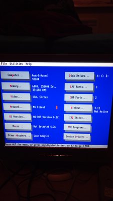

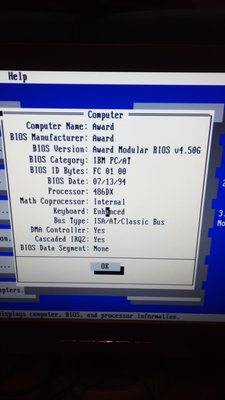

I'll take some pictures form msd, maybe it helps.

Reply 8 of 16, by derSammler
The description of the adapter clearly says that the mouse must be compatible. It's not a protocoll converter, just a passive adapter.
Are the COM port cables you use for the I/O card, or did you just use ones that fit? There were two different pinout, numbered and zig-zag. They are not interchangeable. Most common cause for non-working ports are wrong COM port cables.
