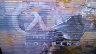

Thanks for all advices but now I have this in 3D games. Can I fix it somehow?

Reply 8 of 20, by Deksor
That doesn't look good, your voodoo card might be defective unfortunately ...
Reply 10 of 20, by chinny22
if you plug the screen direct into the voodoo?
You may get lucky and just be the pass-through cable
Reply 11 of 20, by Munx
Nah that's not the cable, it's the card.
Are you familiar with v1tweek? Use it to downclock your Voodoo to something like 45 Mhz and see if that helps.

Reply 13 of 20, by Munx
Yes. This means the problem is either with the drivers or other piece of hardware.

Reply 16 of 20, by haker120
Thanks, now I'm installing win98SE but my mobo doesn't want to run bootable disc, just spits failure but I've run installer from floppy. I regret I didn't ask earlier for help. xD
Now what Voodoo drivers should I install? The rest drivers don't cause problems.
Reply 17 of 20, by Munx
Go with 3.00.01 (second to latest drivers). The latest ones (3.01.00) allegedly have slightly reduced performance.
