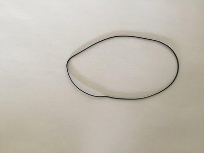

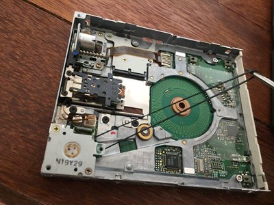

Hello Gentlemans, I need some advice from our friends regarding floppy drives.
I have a EPSON action note 866 from 1994 and I'm facing an issue with his internal 3,5 floppy drive (vendor is CITZEN). The one that was sent inside of the computer came without the rubber belt and with a ruined reading head (those damm ebay sellers) so I got another drive from Germany. This one seemed perfect (reading head was like new and a rubber belt was present), but it is still not working (shows a not ready reading drive A). I've attached some videos showing all the movements of the reading head and it really seems all in order, but for some reason the drive does a low level "roar" (sorry, best word that I could find here to describe it) when I insert the floppy and it does not read anything at all.
Everything that I saw related to this defect online points to belt issues, and since I'm not experienced in evaluating it's quality I cannot judge if this is the issue.
My question is: Have you ever found such issue before with 3,5 drives? What the pictures tell to you guys? The laptop is a jewel, and the only thing missing is the funcitional floppy drive.

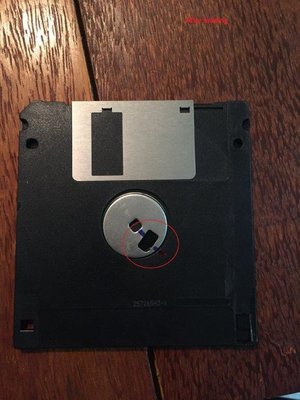

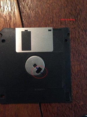

Reply 2 of 10, by SW-SSG
I don't think the forum supports uploading videos; you will want to use YouTube or something.
Anyway, can you verify that the disk is actually rotating upon drive access? Normally, a drive having a "belt problem" == disk isn't spinning at correct speed, or at all.

I have 4 x w1d floppy drives. I was able to repair all of them.
You just have to replace the rubber with a new one. Boiling will not work.

I've some w1d drives laying about waiting for new rubbers. Spent time last summer trying to improvise a diy belt, but ended up getting a pack of 30 or so belts of various sizes from china for $2 shipped. Haven't tried them yet. Those individual belts from germany are so overpriced man.

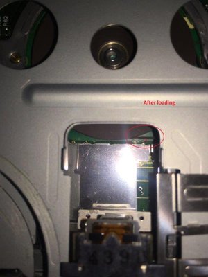

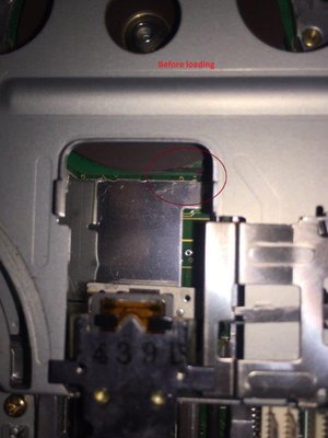

Thanks for the inputs. I made a small test here, which is to put the disk, make a marker indication on it and try to load it from the drive, as bellow. No difference from picture 1 (before loading) and picture 2 (after loading).
Then I did a second trial which was to make a small mark in the belt and see after loading if it has movement. Result: no movement.
Conclusion: Bad belt on the drive...and I'm stuck with it.
Before putting more money to it, do anyone has any suggestions on how to fix it? Belt replacement (in this case, a belt from W1D drive) is the only solution?
