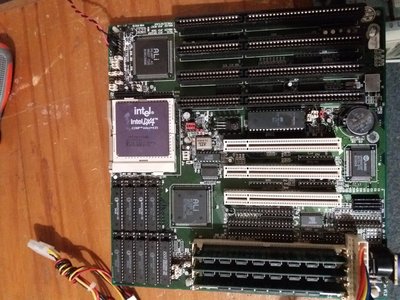

But i have a problem with them: the board works fine with a isa vga card nomatter which isa slot i use for it but none of the 3 pci slots works with a pci vga card. I tested a couple of them (i know they are working cards) and only get 8 short beeps, no display at all. The light on my kvm switch does come on (this usually means i get a display) but the screen stays black. With isa no beeps and the display goes on.
Setting isa or pci vga in bios does not change a thing. Also tried the fail safe settings.
Got this board without a bios chip and hotflashed a chip on another board with a AMI bios file i found online: 918_Bios_19961230_AMI.zip
I guess it is the right file as it boots with an isa card, does everything else and also boots from a floppy disk, but what could be the reason it won't post with a pci card?
2 things that are not correct: in bios there are settings for irq for 4 pci slots, i only have 3 slots on my board. And during post it always says ''256kb cache ok'' even when i insert only 128kb cache with the right jumper settings. Speedsys DOES report and measure the right amount of cache (128kb and 256kb) so it looks like a fake cache bios for another version of the board?
I can not find any physical damage on the board, front or back.

Sounds like your PCI routing table in the BIOS is messed up. Can you post a photo of the board? The M918 is the board with the ALi BIOS, is that right? I have this motherboard in a box; it is a piece of junk. I also have the M915 (dead) and M919. Post a photo and I'll dig out the board and copy the BIOS.
Reply 4 of 19, by meljor
It's a ALI chipset board with AMI bios. Thank you for uploading! Does your board have real cache or fake? Mine has real chips. This is the photo from my own board:

Reply 6 of 19, by feipoa
Attached is the copy of the AMI BIOS from my M918 v1.2. I'm not sure which revision of BIOS this is.
Any reason why you want to use the M918? I did some testing on this board many years back and found that the cache and/or memory throughput was pretty bad. The only way to even get a visible response from the L2 cache in Speedsys was to set the DRAM memory timings very slow, otherwise, it appears as if there is no L2 cache installed. At first I thought it was an issue specific to the ALi chipset, but I didn't have this issue on other brand boards based on this chipset. It might be worthwhile for me to test the other brand BIOSes on this board.
My cache is real, I checked it with an SRAM tester, though it is from a brand which I've never seen before, KIMS. I have also tried other SRAM.
Reply 7 of 19, by meljor
Well, with the bios i had i did a quick test (with isa card) and speedsys gave 41.98 speed index for 486 dx4-100 Intel cpu (not so bad) 85 mb/s for L1 35mb/s, for L2 and 30mb/s for memory so yeah, difference between mem and L2 is pretty lame and nearly non-existent. This is with the fastest bios settings.
Scores are not high overall but i never get the extreme high scores with any board i try, not even with my Gigabyte 486am/s. But that one IS faster, that's for sure.
Now i tried your bios Feipoa (thanks again!) and it is acting even weirder: Still posts only with isa card but now it won't even boot. As soon as it should show the very last screen and start from floppy the screen turns black. Even after setting the slowest timings, disabling caches and setting fail-safe options.
It DOES give irq options for only 3 pci slots in bios as it should but otherwise it is even worse. Anyway, in both cases the board seems defective as i can not get a picture from the pci slot. Too bad.

The GA-5486AL contains the same chipset as the M918. How about trying the GA bios in the M918? I have attached the GA BIOS.
Reply 9 of 19, by meljor
Will try, who knows 😎
Reply 10 of 19, by meljor
Works exactly the same with the Gigabyte bios (award instead of ami!), so i think there is something wrong with the board unfortunately and pci simply doesn't work anymore.
Memory needed to be set one notch back with the gigabyte bios, otherwise it would lock up. So i set it at fast instead of fastest and did a quick run of speedsys. The outcome was about the same as with your m918 bios (tiny bit slower on the memory) so it has nothing to do with the bios, it's the board that's quite slow. At least we've learned something here 🤣
Thanx again for the help!
