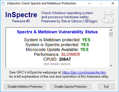

Checked my ASUS X54C running Windows 10 Pro x64.
CPU: Intel Celeron B820.
Results:
Meltdown protected: YES
Spectre protected: YES
Microcode update available: YES
Performance: SLOWER
Screenshot:
17.22 KiB
375 views
Results

I think everything older than Haswell (ie Core 4xxx) will report "slower". There is a PCID feature on the newer CPUs that mostly alleviates the performance hit of the security workaround.
But really I haven't noticed my older stuff being slower. I hear storage I/O is by far the worst hit area. Might need benchmarks to notice for the most part.
