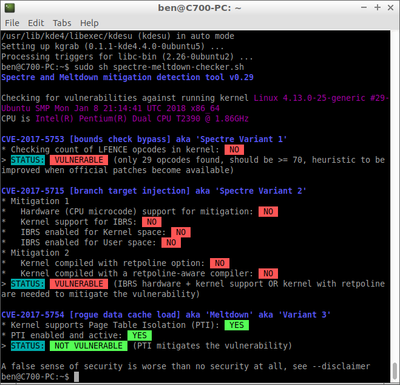

My Presario C700 has the second level Spectre vulnerability and the Meltdown as well. Unfortunately, there are no patches for the 32-bit version of linux, only the 64-bit version of linux has the patches available.
Edit (1/14/18 @ 13:12 or 1:12pm): My laptop has all 3 vulnerabilities after installing the 64-bit version of linux.
Reply 70 of 151, by bjwil1991
Here are my results after installing the 64-bit version of linux:
119.59 KiB
755 views
Bug results

Reply 72 of 151, by Scali
It appears that these tools report 'vulnerable' when they detect an unpatched kernel.
I would rather see a proof-of-concept that actually reads from kernel memory. That's the only way to prove whether a CPU is vulnerable.
Reply 73 of 151, by gdjacobs
My impression was the same. The tools are primarily for checking the kernel and microcode to make sure workarounds have been installed. Details are sketchy on which older generations of hardware are impacted.
