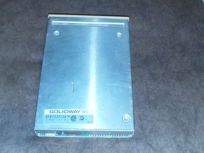

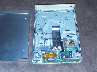

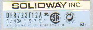

Reply 6 of 8, by Jo22
Update. I disassembled the old 720KB floppy drive and cleaned it.
In case you are curious, it is a DFR723F12A from SOLIDWAY INC. 😀

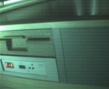

Reply 8 of 8, by Jo22
Update. I installed the Gotek in place of the old 720KB drive.
As you can see, the primary drive is still a good old 360KB 5.25" drive.
Mounting the floppy emulator was a bit of a work, though, since the 3.5" to 5.25" frame had outdated specs:
The spaceings for the mounting holes on the sides were that of ancient 5.25" MFM/RLL drives.
And I am talking about the frame itself, not just its inner frame that holds a 3.5" drive!
That's why it was not possible to simply replace that old frame by a modern model from the 90s.
What I finally did, was to use the bottom mounting holes of the Gotek.
They were compatible with the old 720KB drive. 😀
