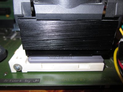

Just go by size and use good heat transfer paste.
A high(spacially) SS7 cooler is often enough to transfer plenty of heat.
Of course nobody can give any guarantees on how long the cpu is able to withstand said "punishment".
I see old cpus still working, despite having been too hot to touch while running for 20 years, so I take the guess that a well cooled "part" may survive its owner.

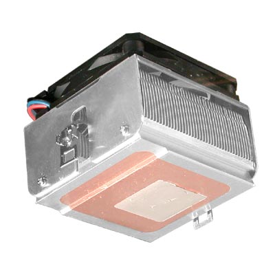

The best type of cooler is going to be one with thin fins. Most of the old coolers had horribly thick fins which are really bad for heat dissipation.
I picked up a couple of these last year for socket 7 builds.
http://www.antec.com/product.php?id=705027&lan=nz
19.32 KiB
398 views

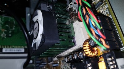

I can't say I have very thin fins. Here is a picture. Fan is this one http://gelidsolutions.com/thermal-solutions/c … e-fan-silent-5/
I didn't really have anything else to replace it with currently. Thermal paste is just normal arctic silver 5.
Still, the heat sink has never even gotten warm during my tests. It would be nice to be able to see the actual cpu temperature numbers.
I assume the temperatures are probably closet to normal k6-3 because I am using higher voltage than 1.6V.
3.33 MiB
384 views

You severely underestimate exactly how hot the original K6-III chips ran.
They were also on a larger process node of .25 instead of the .18 of the + models.
Stock voltage for the normal K6-III chips was also higher at 2.2v-2.4v.
When the K6-III chips came out, the biggest con was how hot they ran and second was how poorly they overclocked because of that.
The K6-II+ and K6-III+ are probably A-OK with the not so good heatsinks because of how cool they run compared to the K6-II and especially K6-III chips.
I just like to have really good cooling and really despised and still despise the crappy coolers that were available back then.
