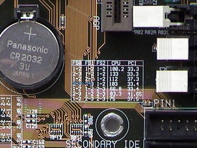

The P2B doesn't have BIOS based settings for the clock speeds and ratios. The P3B does though.
The PCI setting that said 32 might be the "PCI Latency" or whatever it's called, which is something different.
I have some old pictures of a P2B, so I've attached a photo of the board markings that describe how the PCI clock is controlled. It's part of the same set of jumpers that also sets the FSB speed.
86.91 KiB
1007 views
Actually, it looks like the only setting they have documented on Rev1.02 for 100FSB is the one that also puts PCI at 33MHz, so if your settings match that line then it's correct. But if it doesn't match that line, there probably is an undocumented setting that would cause the PCI to be overclocked.
I suspect this isn't your problem though, I'm more suspicious of the AGP clock.
I didn't find a picture of the jumper for the AGP setting, but as I recall there is a separate jumper somewhere which toggles the AGP clock between 1/1 and 2/3 of the FSB speed. At 100FSB you'd need to set that to 2/3 so the AGP clock will be at 66MHz. Although it does support AGP2X transfers, the AGP clock is still supposed to be at 66MHz. If the AGP is at 100MHz it would probably be very unstable.

Just checked google for images of that jumper and to my disappointment the board lacks such a feature.
It's just a plain P2B with no extra letter, revision 1.02.

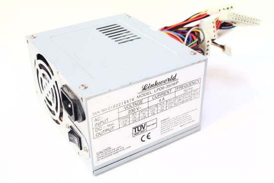

As for the PSU, this is what I'm using: http://www.electromyne.com/images/131901a.jpg
I even tried running it with the Corsair CX430 from my main PC which also didn't help.

Based on Win95 working, it tends to point away from power. But as far as the PSUs are concerned, I found a closeup picture of the label for the Linkworld LPD6-350WP and it doesn't specify a max combined wattage for the +3.3V and +5V rails. However, based on the fact that it claims higher amperage on those rails than for the +12V rail, it implies it's probably designed for this era of system. I don't know how reliable or well designed it is, I'm not familiar with it.
The modern Corsair CX430 expects most of it's load to be on the +12V rail, and is only rated for 110W total between the +3.3V and +5V rails. In principle that's certainly enough for steady state operation, but I'm not sure how reliably it would power a late 90s system while under load, but if the configuration was stripped down then it was probably enough. The other question in my mind is whether those rails are independently regulated (on some PSUs, if 3.3v and 5v are unevenly loaded then their regulation can drift in opposite directions).
