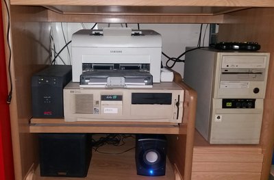

First post, by Anaxagoras
Hi.
This is my 486.
The first computer that I bought with my own money, and still works!!! 😀

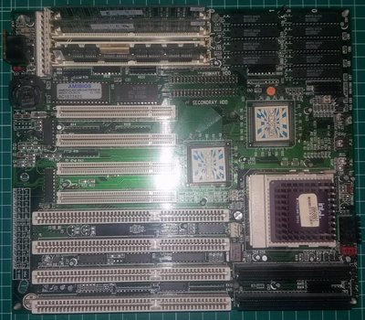

- It's an Intel 486DX4 @ 100Mhz and no needs a CPU fan, only a little heatsink.
- The mainboard is a VIP (VESA, ISA, PCI... I think).
- 32MB of RAM (2x8, 1x16), more than enough for me.
- SIS SVGA (PCI) with 1MB of memory.

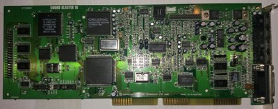

- Sound Blaster 16 CT2830 (ISA).

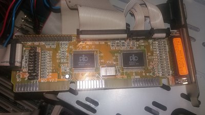

- Serial / parallel ports and floppy controller (ISA).
- FDD 5,25" DD (1,2Mb).
- FDD 3,5" HD (1,44Mb).

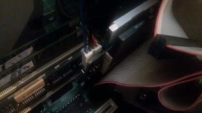

- IDE to CF adapter:
1 CF 2GB (1 FAT partition).
1 HD 4GB, CF card size, pulled from broken MP3 player device (2 FAT partitions).
- CDROM 4x Panasonic.
- SONY Trinitron Multiscan 200GS (17").
- Standard keyboard (since 1995).
- Logitech 3 buttons serial mouse.
The original hardware specs (1995):
- CPU 484DX4 @ 100Mhz.
- 4MB RAM.
- FDD 3,5"
- No CD, no Audio Card.
- 14" monitor (MIA).
- Serial mouse (MIA).
A few months later I build the first upgrade, a "Multimedia Kit":
- Audio Excel 16 DSP a Sound Blaseter Pro compatible PCI card.
- Stereo powered speakers.
I remember the first game that I use to test the sound... Pinball Fantasies. I could not believe what I was hearing. Awesome. My previous PC (a XT clone) only has internal speaker.
During more than a decade this 486 was boxed and stored, with some exceptions, for example when was running as a firewall.
Recently I rescue it from a wardrobe to make some changes on it to back to live.
- The HDD was replaced by two CF cards.
- Audio Excel sound card replaced by Sound Blaster 16.
- New battery.

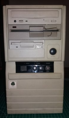

- Added a second FDD, 5.25"
- Fixed a CPU Clock Speed Display.
17" CRT monitor, new 2.1 speakers and new manufactured serial mouse completes this 486 setup.

Front view

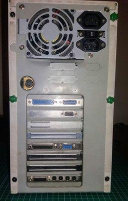

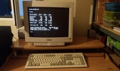

More pictures...
1.38 MiB
2059 views
Back view
1.09 MiB
2059 views
Running @100Mhz with turbo
1.72 MiB
2059 views
Desktop

Be aware that your mainboard has fake cache(PC Chips board) and you could solder on sockets if traces are present.
Fake cache? really? 🙁
I need to learn more about this before put the hands on it.
Thanks for your advice... More than 20 years with my 486 and it is a fake!!!

No worries, it's not that bad... you didn't mind the last 20 years so don't be too concerend.
Your srams bear the dreaded "WriteBack" signature which is known to signal fake ic-placeholders usually planted in boards made by PC Chips. Also your chipset "features" stickers which hide the original manufacturer's identity and code - most likely UMC.
If you're not playing games which push your 486 then just leave the board as is.
It's a nice rig nonetheless.

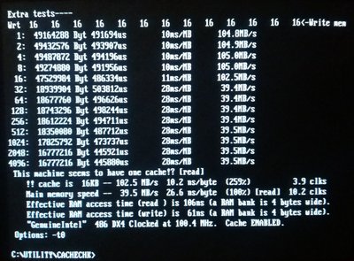

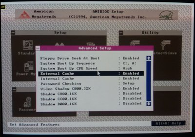

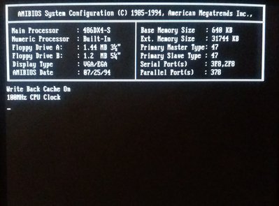

Hi again,
I have been reading about the fake cache and I have to say that my mainboard has not external cache.
Stickers, BIOS chip soldered directly in the mainboard, and after read this excellent article from Redhill and others threads I think that Write-Back "chips" seems to be a fake 😢
Well, once I understand the meaning and tricks of this fake I continue with several test to be sure.
1.) Both caches enabled.
555.23 KiB
1598 views
486_BIOS_Both_caches_enabled
836.37 KiB
1598 views
486_Cachecheck_Both_caches_enabled

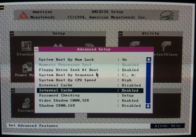

2.) Internal cache enabled and external cache disable.
1.02 MiB
1598 views
486_BIOS_L1_Enabled_L2_Disable

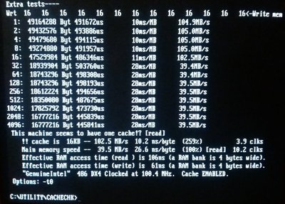

744.92 KiB
1598 views
486_Checkcache_L1_Enabled_L2_Disable
As you can view the cachecheck report is the same in both cases. Only one cache with 16KB size.
The only thing that changes is a message in startup... Write Back Cache On 😠 😠 😠
656.4 KiB
1598 views
"Write Back Cache On" fake message
Because of this I leave the external cache disable from BIOS since it no have any but report true info to DOS (I hope).
The performance falling down when L1 is disable, more than when I turn off the turbo button. For example, Doom is unplayable.

The WriteBack chips are obviously fake not only for the reason that there was never a vendor with said name but also because they are soldered onto the board - this was not common for 486 era "stuff" which featured cache chips in "sdip" format.
As already mentioned you can take them out, put sockets in and improve the board's performance - given there are traces leading to the rams and you're in for some tedious groundwork.

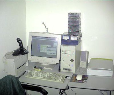

I seriously wish i knew what i did with mine, my very first... i also had a dx4-100mhz system, i bought it new back in mar1996 for my b-day from computer shopper when i was stationed overseas in the azores.
Sadly, this is the only picture i could find, and this is from mid 1997 when i came back to the states.
Specs - intel dx4 100mhz / 8mb edo / unknown motherboard-chipset with isa and pci slots / 850mb hdd / cirrus logic 1mb pci video card / opti930 isa sound card / 4x cdrom / at keyboard / serial 3button ball mouse / ctx 14'' crt / 3.5" floppy / mini at case with pwr-rst-trbo buttons and 2.5 digit led display showing cpu clock speed / 250w at psu and a set of generic speakers(not the yamaha ones pictured), only came with dos6.22, and all for $1200 shipped.
