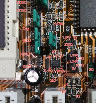

The pass transistor is the device in the TO-220 package (standing up with the metal tab). In the simplest sense, it provides (in the context of this circuit) a controllable resistance based on the input from the 2951 regulator, like an electronically controlled rheostat. Based on your drawing, I'm assuming we're dealing with the base or gate (i.e. the control input) on the right most pin (generally referred to as pin 1) which is typical for TO-220 transistors. If the impedance across the other two pins in either direction is less than 10s or 100s of kOhms, the device has likely failed short, should be removed from circuit (and tested to confirm another part in the circuit hasn't failed), and replaced if confirmed to be bad.
Through my own fault (CPU orientation) I fried the VRM functionality of a LS486E Rev C1. At 5 Volt CPU voltage the board functions OK. What components are likely to be defective? The TIP127A PNP Transistor (TO-220 package) or that tiny LP2951CM (SMD SOIC-8 package?) How can I find out with just a multimeter? I measure a fluctuating 0 to 1 Volt on the back of the TIP127A. Maybe start by replacing the TIP127A with a TIP125 and see how it goes?

I'm guessing the VRM is fairly similar to the LP2951 linear regulator circuit in the application notes, only using a PNP transistor instead of a MOSFET. Test Vbe and Vce to see if the TIP127A isn't failed short, failed open, and that the gate is in decent shape. If the PNP seems okay, it'll be in the passives or the regulator control IC.
Reply 27 of 50, by gerwin
Thanks for the suggestions! I am not that knowledgable to say wheter or not a PNP transistor is in shape, not yet. Attached some of the measurements I did: Voltages while running and resistances with the board powered off.
The solder at the capacitor near the 8 ohm resistors looks odd, and how come over the big resistor is Zero Ohm?

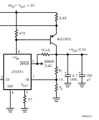

Reply 28 of 50, by gdjacobs

For reference, I expect the regulator will be similar in structure to the example from the application notes above, potentially with some differences in the passives and potentially with the error signal strapped down.
Looking at the measurements, the base appears to be connected as expected, but Veb is way high. I suspect that TIP127 might be caca. It should be in hard saturation with those voltages, but Vce is -3.5V where in saturation it should be -0.5V max.

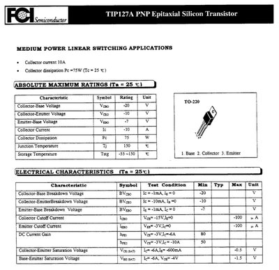

gerwin wrote:
I replaced the TIP127A this evening. Put a TIP127 in its spot.
Can anyone clarify for good what type of transistor does this board use for its VRM? Some time ago I was admonished for suggesting (for this exact board) a standard PNP instead of a Darlington. But the board originally had a TIP127A installed, and it seems that it's not a Darlington at all. Anyway, glad that it's working regardless of the transistor type 😀
    218.9 KiB
    933 views
Reply 34 of 50, by gerwin
I noticed that datasheet and the absence of "darlington" as well. But TIP127A is rather obscure, ebay has zero results on that term, whereas TIP127 gives 122 results. Actually even TIP127 is not available at for example Conrad.nl.
But I am not very knowledgeable about transistor variants, and I read somewhere on vogons that TIP125/126/127 would be OK, and just went ahead. Regardless, my measurements of 3,40 Volt Vcc (default) and 3,60 Volt (change of jumper 13, resistor modded from 4V default) are what they are. The system is running with an Am5x86 133MHz (FSB 33MHz), no problems.
Reminder: "About the big green resistor: Can someone with this board please measure it for me? I think it says Yellow, blue, gold, silver = 4,6 Ohm 10%. But the one that was removed from this board measures around 0,5 Ohm?"
Reply 36 of 50, by Roman555
It's not a resistor. It's an inductor. You can see a reference designator "L4" near it.
I think it is a filter for power supply of the PLL.
So "Yellow, blue (violet), gold, silver" = 4,7mkH 10%. And its resistance for direct current is near 0 Ohm. I've just measured.
