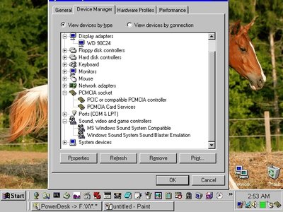

Here's a photo below of my Win98SE Device Manager. You're right, it doesn't show the Class IDs unfortunately.
I've also included two archives, one of WD Win311 256color video drivers, and a small compilation of drivers, notes, and the Zenith System reference I've collected over the years.
See the README.TXT for some more info, they both fit on floppies.
If you run ZINFO.EXE (directory 03 in my zip), it gives you some info on your Noteflex hardware. I've included mine for reference. If you also see in the readme in Q129812.ZIP file (directory 09-PCMCIA), it says the PCIC is Cirrus Logic based. That's all I can find.
About the sound, I'm not sure how you installed the WSS drivers. Did you pick "WSS Compatible" during setup? After install WSSXLAT.EXE should be in the directory you installed WSS into. Anyway, I've included both WSSXLAT.EXE and the WSSCNFG.EXE config.sys configurator. All you should need is WSSXLAT.EXE. Just run it in DOS and it should work. If it doesn't work at first, reset the system (rest button above the power button) and try again a few times. Settings will be IO220-IRQ10-DMA1.
Finally Sammy, could you tell me what drivers you are using in W311 to get 16bit colors? I find that amazing, I couldn't even try that until I loaded Win98SE.
