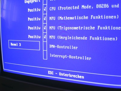

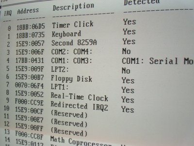

Reply 6 of 8, by Jo22
emosun wrote:
Jo22 wrote:
Maybe the DMA controller is having trouble. The Floppy Disk Controller uses DMA2/IRQ6.
Also make sure things like EMM386 or UMBPCI are not running while you are testing.
so how would i go about check for those?
Hi, CheckIt! checks the DMA channels if you select the mainboard test.
IRQ6, on the other hand, can be checked by Microsoft Diagnostics (MSD).
(CheckIt! also can show IRQs, but usually does not list any floppy controllers)
Edit: You can also give Dr. Hardware a try. 😀
Maybe it can do similar tests (I am not sure, since it has been a while since I used it).
