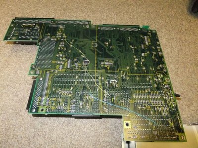

I upgraded the CPUs using a Cyrix 486DRx2, a TI 486SLC2 and a TI 486DLC and modified the motherboard to add the A20 gate and Flush signals to the CPUs where required:

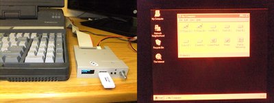

The T5200 has an option to connect a second floppy drive to the printer port which can be switched as either the A: or B: drive so I made up a cable and used it with a Gotek USB floppy emulator with FlashFloppy firmware.
426.07 KiB
13916 views

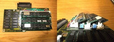

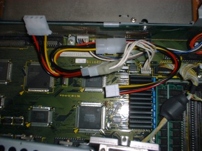

One of the machines had 14MB of RAM, the second had 6MB and the last had only the standard 2MB so I modified that one by removing the proprietary SIMM slots from the RAM expansion board and making a small sub board with standard 72 pin SIMM slots. I then wired that to the RAM expansion board giving 14MB on that machine (2x2MB +1x8MB SIMMs).
468.47 KiB
13915 views

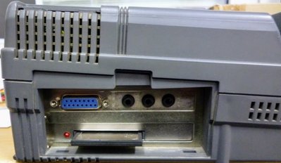

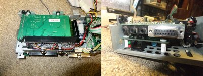

On that same machine I mounted two extra ISA cards in the space where the hard drive was (A network card and a sound card) and used the two standard ISA slots for other ISA cards
523.79 KiB
13915 views

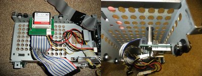

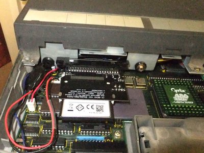

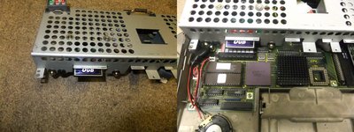

This meant that I couldn't use the same space to mount the CF card on that machine so I came up with an alternative mounting which used a different type of CF adapter with a very short IDE extension cable bent around the adapter so that it could be mounted directly above the IDE socket.
389.17 KiB
13915 views
295.8 KiB
13915 views

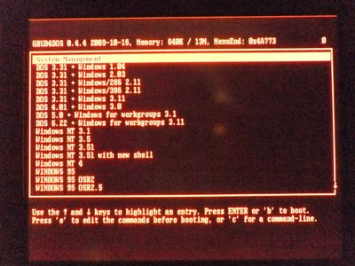

Finally, to make use of the large CF cards I used grub4dos to make a multiboot system so I could boot virtually any OS that would run on the system.
311.81 KiB
13915 views
If anyone wants any further details on any of these mods, please let me know.

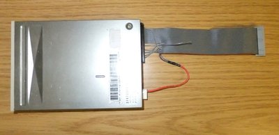

Details of the adapter leads for a floppy would be useful ..and probably my first job.

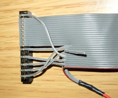

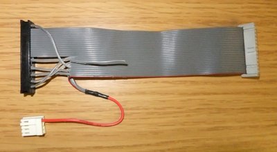

Here are the construction details for the internal floppy adapter:
You will need 34 way and 26 way IDC headers and a 26 way ribbon cable of suitable length
Mount the 26 way IDC on one end of the ribbon cable as normal with the red wire going to pin 1.
Split the ribbon cable at the other end between wires 11 and 12. (red wire is pin 1)
The piece of ribbon with wires 12 to 26 should be inserted into the IDC header so that wire 12 makes contact with pin 18 and wire 26 makes contact with pin 32 leaving pins 33 & 34 at the end unconnected.
This connects the following pins:
wire 12 >> pin 18 !FDCDRC >> !Direction
wire 13 >> pin 19 GND
wire 14 >> pin 20 !STEP >> !STEP
wire 15 >> pin 21 GND
wire 16 >> pin 22 !WDATA >> !Write data
wire 17 >> pin 23 GND
wire 18 >> pin 24 !WGATE >> !Write enable
wire 19 >> pin 25 GND
wire 20 >> pin 26 !TRACK0 >> !Track 0
wire 21 >> pin 27 GND
wire 22 >> pin 28 !WPROTC >> !Write protect
wire 23 >> pin 29 GND
wire 24 >> pin 30 !RDDA >> !Read data
wire 25 >> pin 31 GND
wire 26 >> pin 32 !SIDE >> !Side select
Clamp the IDC as normal then remove the top of the IDC header to reveal the unconnected IDC pins.
Then connect each of the following wires to each IDC pin as follows:
wire 2 >> pin 8 !INDEX >> !Index
wire 4 >> pin 12 !FDSELA >> !Drive select B
wire 6 >> pin 34 !DSKCHG >> !Disk change
wire 8 >> pin 5 !READY >> GND (Ready is not a signal present on IBM type floppies but needs to be grounded to work)
wire 10 >> pin 16 !MONA >> !Motor on B
wire 11 >> pin 2 !LOWDNS >> !High density
The easiest way to make the above connections is to drape a wire over the required IDC pin then refit the top of the header and press it together by hand.
Remove the top again and repeat for the next wire. You may break the latches on the top with this continual removal but it can still be used to push the wires on the pins, after which it should be replaced by an intact one from another 34 way header.
Finally, the first four remaining unconnected wires (1,3,5 & 7) which are all +5v can be soldered together and connected to the +5v line of a floppy drive power connector (0v comes from the GND on pins on the 34 way connecter).
Note that this can only be used if the floppy drive is +5v only, many early drives used both +12v and +5v. In this case, the +5v lines should be insulated and a molex splitter used to split the supply to the hard drive.
Wire 9 (!NOTCH) is the status of the HD hole in the floppy. This is used by the BIOS to determine the size of floppy inserted and if you try to format a floppy of the wrong size you get an error "Parameters not supported by drive". Unfortunately standard floppy drives don't have this signal so you either have to ground it (for 1.44MB) or leave it floating (for 720K) which means you can't format one size of floppy although you can always read & write correctly formatted 720K & 1.44MB floppies irrespective of the state of this signal. The BIOS call that generates this error is not used by the formatter in DOS 3.3x so you can always format any size disk by booting to DOS 3.3x first. (Some T5200s with original floppy drives also generate this error when trying to format 1.44MB drives so that signal might not be available on some original floppy drives but they were supplied with DOS 3.3 so it didn't cause a problem at the time)
To avoid these problems, my patched BIOS versions for both the T5200 and T3200SX have removed the check of this status bit so they will format any floppy with any DOS version. (Obviously you can still only format a floppy according to it's capacity)
If you are running my patched BIOS, the state of Wire 9 doesn't matter, if you are not using my BIOS, then Wire 9 should be grounded or left floating depending on what size floppies you want to format most and then boot to DOS3.3 to format the other size (gnd = 1.44MB, float = 720K).
If grounding wire 9, connect it to another ground pin such as pin 7 although if you have a floppy drive with ground pins removed (see below), you will have to join it to the wire going to pin 5.
Warning: Some drives (e.g. more recent Mitsumi drives) don't have all the GND pins fitted on the 34 way socket. This means that the !READY signal might not make contact with GND if pin 5 is missing and the drive may not work. Pin 5 is present on the Mitsumi drives which is why that one is used but if other manufacturers did the same thing and didn't have pin 5 then you might have to move that wire to another pin or connect it directly to GND.
Also as there are fewer GND pins, there may be insufficient GND return for the +5V supply in which case the molex splitter should be used. I suggest avoiding this type of drive if you have a choice.
Here are some pics:
(Wire 9 is left floating in these pics but should probably be grounded as mentioned above)
672.69 KiB
13885 views
922.72 KiB
13885 views
583.58 KiB
13885 views
Edit:
Strictly speaking, grounding the !READY line is not an ideal solution as it is then grounded for all floppy drives connected to the bus, although doing it this way is a simple solution which doesn't require any soldering if you use a molex splitter for power. I don't think this will have any effect on the T5200 although it might cause problems if this cable is used on another system with other drives. It might also cause issues with the original Toshiba 5.25" external floppy drive if that made use of the !READY signal. (There won't be any problems with 3.5" external drives as they don't have the !READY signal anyway). In the unlikely event that this is an issue, it may be fixed as follows:
Remove wire 8 from pin 5 of the 34 way IDC and solder it to the unbanded end of a high current (1A or so) schottky diode and solder the other (banded) end of the diode to wire 10 (!MONA/!motor on B) while leaving that wire connected to both IDC connectors (normal diodes don't seem to work with all drives due to their voltage drop - maybe a more complex transistor circuit would be better). To do this means scraping away the insulation of wire 10 to expose the bare metal for soldering. This change makes the !READY signal follow the motor on signal.

Reply 4 of 539, by Vipersan
Thanx for the detailed info Ian ..
very helpful..though I had planned to power my floppy this way.

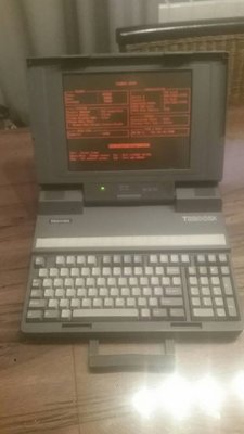

59.68 KiB
13841 views
I had T5200, but prefer T3200SX myself (visually I like classic plastics more than this strange coating on T5200). Who knows, though, maybe I'll get another one some day.

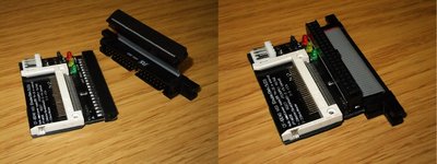

It is also interesting to see that we have come with similar, but different solutions to the same problems. For example, jaZz_KCS solved the proprietary FDD issue by using ISA I/O controller, while in my T3200SX the CF card is accessible via opening for ISA cards on the far left
I looked at using a ISA slot CF adapter but I was using both ISA card slots in the machines so the internal solution was preferable.
I actually like my retro rigs NOT having network or internet access. When I can whip out CF card and add any software or files needed from my regular machine, I don't really need it. Hence - easily accessible CF card.

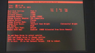

BIOS is a bit of a mystery to me. I knew there were versions that accepted only Conner drives and some that could use others. But I never knew they were made by two different providers. How do you even begin looking into BIOS of these machines, let alone modify it?
After some googling, I could see that there are indeed two different versions of BIOS screen that look nothing like one another (see below). Is one Award and the other one Phoenix?
Yes, the first one is the Phoenix BIOS and I assume the second one is the Award BIOS although it looks a little different on the T5200

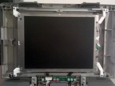

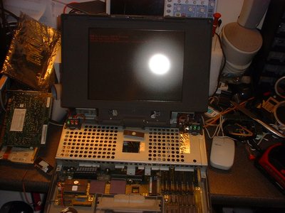

Mods I did here:
replaced original, faulty TFT color screen (it is almost 100% white all the time, and that's a common issue; by the way it's really thick) with a new one, much newer, intended for use with industrial machines. Old screen had 9bit interface, and the newer one had 18bit interface, so I just left half of the R/G/B connectors unconnected and it worked perfectly fine. First I just soldered the wires, but that was a ugly solution so I etched a PCB board with pin header for the LCD cable coming from the mainboard and pads for soldering a flex cable connected to the new screen. New screen had much smaller external frame, so I 3D printed some adapters.
Second mod: that's a simple one, i used hot glue to mount a set of small speakers inside (taken from modern laptop), and soldered the wires to an ESS sound card which had a volume potentiometer 😁 so now I have a fully functional 1990 "laptop" with active screen (nice contrast and response time) and sound; modifications are not visible from the outside.
Third mod: I desoldered built-in ram chips, soldered DIP sockets and tried to replace them with different ones - because sometimes I was getting "PARITY CHECK" error, but now I think that it might have just been a Parity_Boot.A virus 😜
I also think about making new power supply because the original one is big, heavy and noisy (the fan is loud), but the loudness is a "feature" of this machine and trying to change it would remove some authenticity 😜 anyway, it would be really easy to make a PSU which would fit there, off-shelf buck converter modules could be used, and a -5V and -12V rails can be made with mc34063 converter. I already made a really simple prototype some time ago Re: ATX to AT psu converter diagram?, but I would also like to add some protection, like a crowbar circuit or a microcontroller which would measure temperature/voltages and shutdown everything (with a relay?) if something goes wrong.
    39.07 KiB
    13717 views
Nice mods! I wired my internal sound card to the existing "beep" speaker but it's a little quiet.

neither will boot the 5200.
I do not believe it is the bios firmware ..but rather the chips at fault..
I erased one of them and flashed with a copy of my own bios ..thus cloning it..
This cloned bios will not boot either yet the original does..
All chips were flashed and the verified ..and passed..
The only other thing I can think of is that I have to ignore the chip IDs to use them in my TL866 ..
I wonder if somehow the bios actually checks the chip ID before booting it ..and if it fails ...refuses to boot ????
I am certainly no expert in this regard.
I've since ordered 5x more chips for 5 dollars from AliExpress ..so at least 20 days to get here..
These chips are exactly the same number as the original bios ..made by Atmel AM27C1024-205DC
Wheras the 2 I recently purchased were NEC D27C1024D-15
Ian ..?? ..could this small difference in chip type be an issue ?
Or could it be because my programmer does no recognise the chip ID and has to be ignored during read/write operations ??
I'm at a loss here
rgds
VS
Reply 14 of 539, by IanB
Vipersan wrote:
Tested the chips this morning ..neither will boot the 5200. I do not believe it is the bios firmware ..but rather the chips at fault..
I erased one of them and flashed with a copy of my own bios ..thus cloning it.This cloned bios will not boot either yet the original does.
Not sure what the problem is there, I'm using the same chips (D27C1024D-15) from the same supplier so there shouldn't be any fundamental problem with them.
Are there any beeps on startup? Make sure you are plugging them into the right socket as the keyboard controller in front is in the same ceramic package.
Also I suggest clearing the CMOS by removing the battery lead for 30 secs or so when changing between the two types of BIOS (Phonenix & Award).
I've finished incorporating XTIDE into the BIOS now so you can use any size drive on the built in IDE port. It also supports a slave drive although that is only practical with CF cards due to lack of space for a second drive.
I've also made the same patches to the T3200SX BIOS although that is completely untested at the moment (any volunteers?)
I'll post them both sometime later today if tests on the T5200 one go OK

Some news re the bios chips ..
My own cloned bios is now working ..I left the rtc batt disconnected ..and re-seated the chip ..and now it is at least beeping and booting to the point where it asks to strike F2 run setup..
The modded bios however still wont even get to the beep point..
I'll try erasing and flashing again ...though If you post a revision soon I may wait for that ..simply because of the time needed to UV erase..
..a question if I may Ian ..
are you testing on a basic unmodded 5200 as is mine ? ..or on your beautifully modded unit ?
btw ..I may well be able to help test 3200s soon ..as the cracked screen unit I bought will hopefully arrive next week..
providing that is ..that the vga is initialised at bios access ..and doesn't require reset by the plasma screen first.
(a sort of chicken and egg situation ..🤣)
back soon..
VS
Reply 16 of 539, by Vipersan
Now I'm just plain confused..
I have keyboard unplugged
Floppy unplugged
Connor HD unplugged
RTC battery unplugged
I can boot the bios with my phoenix original ..or the cloned phoenix bios chip ..
I erased the 1024 and this time flashed with the unmodded award bios ..
Still no boot as with the modded award bios..
Something about my 5200 doesnt appear to like the Award ??
rgds
VS

Reply 17 of 539, by Vipersan
Tried again ..after pulling the simms ..
Still nothing from the award ..
but I still can get this far with the cloned Phoenix chip.

Reply 18 of 539, by IanB
Edit:
It turned out that the machine had a later 32K VGA BIOS instead of the previous 24K one and that required the 3.xx Phoenix or later 5.30 Award BIOS to work
Here is a zip with all the main BIOS and VGA BIOS versions found so far including patched versions:
T5200 BIOS pack 1-2a.zip
467.01 KiB
429 downloads
This contains BIOS versions 1.20, 1.30, 3.00, 3.10 & 5.30 and the 24K and 32K VGA BIOS
All versions except for 1.20 have been patched and there are two different versions of each patch, one with XTIDE that uses workspace in low memory and one that uses workspace in high memory. See the readme.txt file in the zip for more details.
I'm currently using "T5200 BIOS V5.30 (Award) patch 1.2 with LOMEM XTIDE 640K.BIN" but the others are included in case of any compatibility problems.
