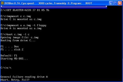

I am using Dosbox. I use "imgmount c c.img" to mount my c drive. This goes well. Then I use "mount a d:\ -t floppy". This goes well too. Now I use "boot c.img -l c" to boot my c drive with DOS/V system. Boot goes well but there is no floppy drive. It says "Not found drive A" in japanese. I tried many things but no use so far. I coudn't successfully mount drive A (floppy drive) at the same time having c drive booted with DOS/V. Please help me and let me know what should I do to have both DOS/V on my c drive and have floppy drive (A:) too?

if you boot, then only imgmount drives are available.
so you have to imgmount your floppy (e.g create an image and imgmount that)

you can mount your harddrive image along (as you did before)
so imgmount c c.img
imgmount a something.img -t floppy
or even use 2 harddrive images.

I have done this already but surprisingly drive A is not there and still says "drive A not found"
this is my dosbox conf:
[autoexec]
imgmount c c.img
imgmount a a.img -t floppy
boot c.img -l c
But still no use.
I have tested two hard drive with success but one hard drive and floppy (boot from hard drive) didn't work
I can have hard drive and floppy only if I boot from floppy but I need to boot from hard drive and have floppy too which didn't worked so far. Attached image clearly shows this:
