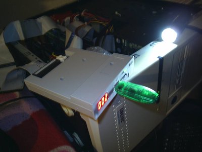

I'm currently toying around with a Gotek device,
and noticed something curious.
Perhaps it's nothing, but I'd like to share it with you anyway.. 😀

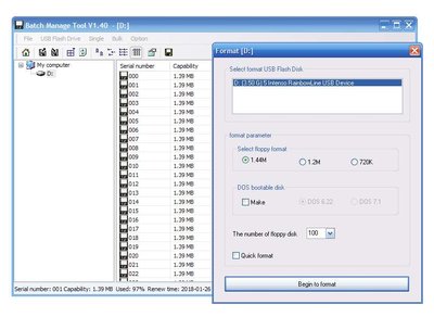

Later, I downloaded the Batch Manage Tool and formatted/partition the 256MB CF card.
This time, it worked. Or so I thought..

That was when I gave up on the card an decided to buy a small, cheap USB pen drive.
After reading that article at pixelnostaglie.de, and because the Gotek uses USB 1.0 anyway,
I thought a that any pen drive with at least 2GB of capacity would be fine for a first test.
Unfortunatelly, times went on since the last time I bought one locally,
so the familiar 2GB and 4GB models were no longer for sale. 🙁
I checked both a local drugstore and an electronics market, but the smallest and cheapest they
had was an 8GB pen drive for ~7€. So I ended up with that (I have no money on the mind, but
experiments like that could damage a thumb drive. So I wanted to start with something cheap).
When I got home, I tried the built-in formatting function again and it worked.
Well, kinda. The formatting stopped at no.24.
So I went back to the Windows machine, ran the Batch Manage Tool and formatted the drive,
and put it in the Gotek again. And it finally worked! Yay!

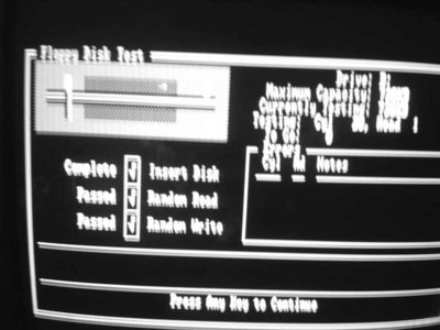

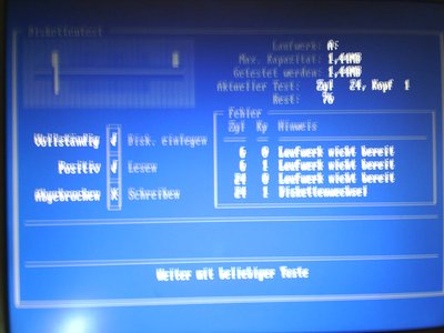

When I ran the Floppy Drive Test in CheckIt! v3, everything seemed fine at first glance.
Until it was performing the random write test. It failed.
But even more so, it crashed -or resetted- the Gotek emulator.
It went back from slot no.002 to slot no.000.
And for some reason, the Gotek did nolonger respond to the buttons until
I switched off the PC and powered it on again.

Even that Batch Manage Tool from ipcas worked fine.
The issues startet at the very moment the Gotek w/ default firmware accessed the drive:
Preparing the new, unused pen drive didn't fully work on the Gotek itself.
(Because of this, I used the ipcas software, see screenshot.)

a) The flashed Gotek had issues in my Pentium 133 PC with a now common high-speed floppy controller (500KBit/s).
Anytime I tried to copy big files (several KBs in size) to an 1.4MB or 720KB virtual drive, I got "a device not ready error".
However, copying them from the Gotek to the HDD was no issue.
b) The flashed Gotek works perfectly fine in my XT-class computer with a slow floppy controller (250KBit/s).
I guess that's no surprise, since that's what the Flash Floppy firmware was made for in the first place (Amigas, Atari STs, etc had them by default).
Copying small or big files makes no difference. Even the CheckIt! Floppy Drive Test now works like a charm. 😁
