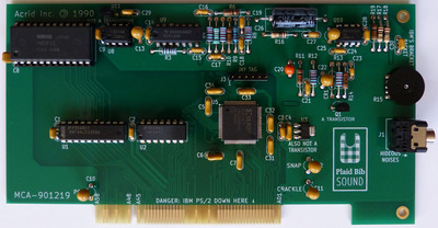

The long wait is over!
I have a working sound card using a CPLD instead of the P82C611. It works in my PS/2 Model 50Z and it seems partially functional in the Model 95 I borrowed (the card ID gets read successfully by the BIOS but the machine can't boot due to issues with the floppy controller.)
Twitter announcement here: https://twitter.com/TubeTimeUS/status/1215071399829622784
Git repo here: https://github.com/schlae/plaid-bib-cpld
If you build the card and get it working in your MCA bus machine, please let me know so I can add it to the compatibility list.
Enjoy!

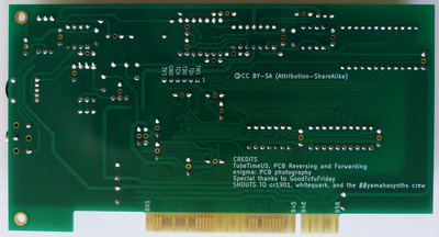

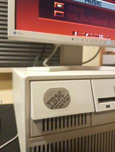

Here is some update from me. Eric sent me a Plaid Bib CPLD Edition and (after 11 days being stuck at customs) it finally arrived today.
It works in my Model 80. The only very minor issue I noticed is that sometimes after exiting Windows for Workgroups 3.11 the card gives loud noise until reinitialized. However this might be some software issue and not the cards fault at all.

It is the small card without shield.

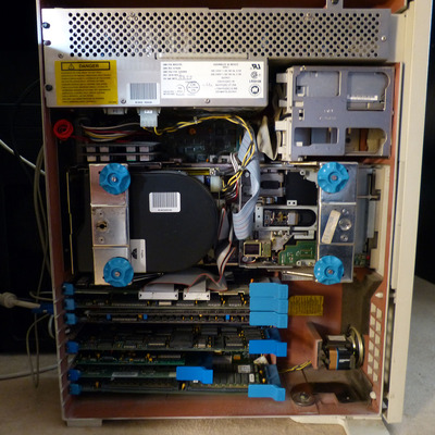

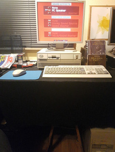

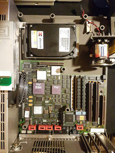

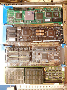

I´m a proud owner of a Ibm Model 70 386 and i am so hyped about the fact that there is finally someone who cares about the old IBM hardware.
Unfortunately, I do have an issue with my Computer. My SCSI Controller doesn´t seem to work properly, so i do have to stick with my old 20MB (still working) ESDI hard drive.
IDE Controllers are just impossible to find 🙁
The Second problem. I don´t have a soundcard. I think my soldering skills are decent (i have already fixed the old floppy drive with some new smd capacitors)
but i do not have any experience in IC programming nor do i know how do i easily get all the components to tackle this project.
Hopefully someone here could give me an advice, because i would love to see this baby running again with many many games and stunning Adlib Sound.
Here are some pictures:
1.57 MiB
508 views
1.54 MiB
508 views
1.21 MiB
508 views
1.19 MiB
508 views
Datasheet:
Intel A80386DX-20 Mhz
20MB ESDI HDD (with Windows 3.1)
4Mb Ram
IBM computer Basic C1.10
MCA Cards (All cards are functioning):
- IBM SCSI-2 F/W Streaming-RAID /A 'Cheetah' (common ADF File dosn´t seem to work)
- XGA Display Adapter/A (FRU P/N 96F7658 | OPT P/N 75X5887)
- Kingston KTM 16000/386 16MB (10MB installed)
- IBM 90x9482 8570/8520 2-6MB Ram Expansion Card (4MB installed)
