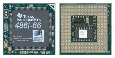

I recently obtained the 3.6 V version of the Texas Instruments 486SXL2-66 on a PGA132 inteposer board. I was able to run this chip at 2x40 MHz, instead of the traditional 2x33 MHz, on various motherboards, including those based on the VIA 481/495, UMC 481/482, SiS 310/320/330, CHIPS 351/355/356, and SiS 460 chipset. I would type cyrix.exe -cd and this would set the CPU into clock doubled mode. Confirmation was checked with Landmark speedtest and CHKCPU. Both confirmed it was in clock-doubled mode.

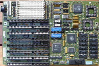

Of course, my main motherboard of interest to run this CPU in, an AMI Mark V Baby Screamer based on the VLSI 320/331/332, is the one which causes trouble. I first tested the SXL2-66 at 66.66 MHz using a 66.666000 MHz crystal. It clock doubles just fine as indicated by Larnmark Speed.exe and CHKCPU.exe. I'm attaching a photo of the motherboard below, not because it is needed, but it seems like posts get better attention with more photos. This photo is from user elianda. My motherboard is in the case and I didn't want to take everything apart to snap a photograph.

My trouble starts when I try to run the CPU at 80 MHz. Before acquiring the 486SXL2-66, I would run a SXL-40 in this system, so it is accustomed to using a 40 MHz FSB. Everything works fine with 1540 SCSI DMA and L1 cache in Windows 3.11. Now when I try to clock-double the SXL2-66 CPU to run at 80 MHz using the cyrix.exe -cd command, CHKCPU.exe indicates that the freq. did not change. I ran Landmark's speed.exe and it confirmed that the ALU results are the same as if the CPU is in single-clock mode. How can this be? I tried using Evergreen TI486SXL program to enable the clock-doubling, e.g. 486CACHE.exe /c2, which says it ran just fine. But when I check with CHKCPU.exe and SPEED.exe, the CPU appears to still be in single-clock mode. So why does the 486SXL2-66 clock double with a 33 MHz FSB, but not with a 40 MHz FSB? And why only when placed in the AMI Mark V Baby Screamer motherboard?
I have other oscillators between 66.66 and 80 MHz which I tried. I ran the Baby Screamer with a 70 MHz OSC, so the FSB would be 35 MHz. The CPU clock doubled just fine. CHKCPU indicates that the internal CPU freq. is 79.7 MHz though, not the 70 MHz I would expect. CHKCPU is not always right with these older oddball configurations though. I then ran the system with a 72 MHz OSC, thus an FSB of 36 MHz. The CPU was able to clock-double and CHKCPU indicated that the system is running at 80.1 MHz. Moving up the ladder, I then tried a 74.5 MHz OSC, and the SXL2 would not clock double. Thus, for 74.5 and 80 MHz oscillators, the SXL2-66 would not clock doubled when used in my AMI Mark V Baby Screamer motherboard. Why? What is preventing it from clock doubling and only in this motherboard and at >36 MHz FSB?
Is it just a coincidence that right around where CHKCPU is indicating the freq. to be 80 MHz is where the CPU stops clock doubling? Is there some kind of function built into the CPU which prevents clock doubling if it thinks the FSB is above 40 MHz? Is there a way to tricking the CPU to thinking the FSB is less than 40 MHz? And why is CHKCPU over reporting the FSB? Even with a SXL-40, CHKCPU thinks the FSB is 45 MHz.
This is not the first time I have witnessed odd behaviour like this. If you use a 486SXL-40 with a 25 MHz FSB (or was it 33 MHz, I forget) and try to clock-double it, it just won't clock double. But if you use a FSB less than a certain amount, e.g. 25 MHz, it will clock double. I don't recall which motherboard I witnessed this on. It may have been the Baby Screamer or another one. The point is that the issue is not specific to the 3.6 V of the 486SXL2-66.
The last thing I can think to try is to use the Cyrix DRx2 software as opposed to the two utilities I have already tried. On this forum, http://www.uncreativelabs.net/phpBB2/viewtopic.php?t=922 , I read that the SXL2 can have issues clock-doubling (no specifics given), but it the following was suggested:
I now have TI486SXL2 working properly in clock doubled mode with cache enabled and coprocessor installed. I had to do some goofy things to get this working properly. I used the Cyrix 486DRx2 control software, but instead of using the software frontend I manually programmed the cx486.cfg to configure CCR0 (control register 0) to hex value of 55.
Anyone have any novel (and practical) ideas to try to get this Baby Screamer working at 2x40 with the 486SXL2?

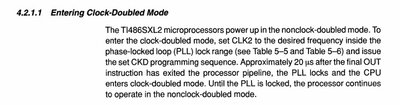

So the cpu won't enable clock doubled mode if the phase locked loop won't lock to the doubled frequency. I guess your CPU's PLL won't overclock to 80Mhz in this motherboard so it stays in single clock mode. Most clock doubled CPUs don't have a switching option so they would just fail to overclock but these TI processors have this more graceful failure mode.
This failure looks marginal as you have it working on other motherboards so it likely is down to voltage drop or noise on the CPU supply rails affecting the PLL. You could try extra decoupling caps soldered across the CPU power supply and ground pins and also running thick cables from the PSU header directly to the CPU supply pins. Maybe even trying a different PSU with a slightly higher +5v rail would help.

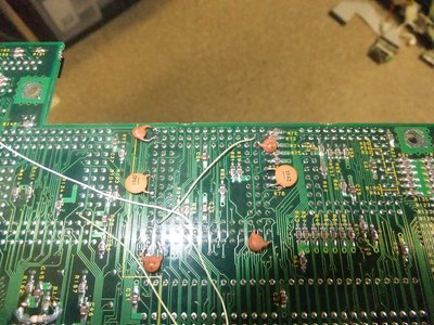

Reply 7 of 21, by IanB
feipoa wrote:
For decoupling capacitors under the PGA-132, what capacitance do you recommend? Any configuration in particular, e.g. 10 V, tantalum/ceramic/niobiumOxide?
I suggest 10n or 100n ceramic caps although they might not have that much effect as the CPU is 3.3V and the adapter board will have it's own regulator and decoupling. You could also try extra decoupling on the adapter board itself if it's easy to fit. The motherboard might be noisier overall compared to the other ones which would affect all signals going to the CPU so may need extra decoupling all over but trying a different PSU is definitely worthwhile as I have seen some later motherboards vary in stability even at stock speeds depending on the PSU used (the PSUs weren't specifically faulty and worked with other motherboards, they probably varied in noise levels and the exact value of the +5v lines)

Reply 8 of 21, by feipoa
That's a good point, I don't think I can improve upon the upgrade module's VRM and onboard decoupling - everything on there is really close together. I also don't want to modify such a rare upgrade CPU. Maybe I will add components to the MB though. I'll swap out the PSU first. I have 2 or 3 more AT PSU's and about fifty (50) P4/Athlon era PSU's and an AT adapter.
What symptoms were you having on your motherboard such that adding those decoupling caps fixed?

Reply 9 of 21, by IanB
I was getting random freezes with windows NT (Dos / Win95 were OK). That decoupling helped and I also added an electrolytic close to the CPU but although it reduced the problem it didn't fix it entirely. I eventually found that adding some more electrolytic decoupling (2x 100uF) close to the RAM on the RAM expansion board fixed it entirely.
These freezes are caused by Windows NT using the HLT instruction to halt the CPU when there is no activity. As a result the CPU stays cool when idle but the current demanded by it varies considerably depending on whether the CPU is executing code or in the halted state and this introduces variation in the +5v level if the PSU can't cope with the rapid changes in loading. This ripple is at relatively low frequency so needs large value low ESR electrolytic decoupling to fix.
This problem only happened with the TX486SXL, not the DRx2 or DLC as presumably the SXL has a greater variation in current demand due to the larger cache. (it certainly runs hotter so must need more current when loaded)

Reply 14 of 21, by IanB
feipoa wrote:
Which version of NT are you using? Were you able to view the low freq. ripple on the SXL's Vcc to Vss pins on a scope?
I was testing with NT4. I didn't view the ripple on a scope.
feipoa wrote:
So are you recommending I do what you did and solder as many ceramic caps to the bottom of the CPU to which ever are the closest Vcc to Vss pins? I can certainly do that.
Yes, to reduce high frequency noise, the decoupling has to be as close to the Vcc and Vss pins as possible (i.e. soldered to them in this case)

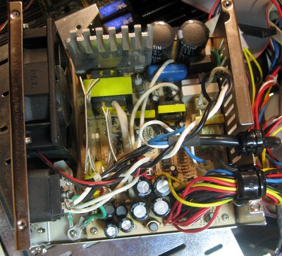

Attached is an image of the inside of my 386's PSU. Do you normally replace those giant high-voltage caps (200V)? What about the others?
Inside there are,
2x 330uF at 200V
2x 471uF at 25V
2x 1000uF at 25V
2x 2200uF at 25V
The smaller ones are,
1x 47uF at 50V
1x 3.3uF
5x 1uF

Reply 17 of 21, by gdjacobs
The bulk caps withstand much less stress than the others. If you have an SCR meter, you can pull and test them, but I doubt they'll need replacement.
Reply 19 of 21, by gdjacobs
For reconditioning, I'd replace everything but the (200V, 330uF) bulk caps. I might even replace those if I can find a good price for caps that size, although that's gilding the lily somewhat.
If you can, I suggest measuring ripple and transient response to see if the caps even require replacement.
