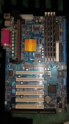

BTW can you make one good picture of your BX2000+, as i don`t have picture of this board, in order to show it to other ppl so they can see what im looking for.
For example picture like this clear and very focused only on the board, thanks.
https://imgur.com/7TQ1Kx5
https://imgur.com/fncgU5n

OK no problem - I'll do the photo (I need it for my website anyway).

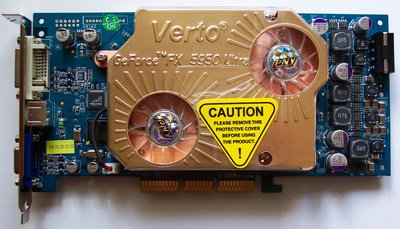

Yeah BX2000+ pared with some adapter like yours blue one (or even better if there is blue Tualatin adapter..) blue SDram modules, or at least the heat sink to be blue, blue Gigabyte IDE cables, blue AGP card like for example Chaintech FX5900 XT, blue 3Dfx PROvideo SLI cards, blue ISA audio card i know there is some Miro Yamaha big ISA audio card that is Blue very nice... The Enermax Coolergiant series is nice, but too bad they have only Red or Gold colors, no Blue.... For PSU can be used a box of Fortron Blue Storm or Epsilon...
Very blue very Intel........ funny as im supporter of AMD/Radeon.....

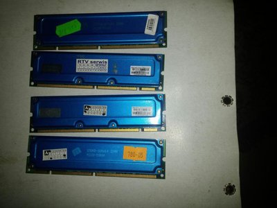

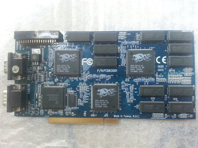

I have blue PCB adapter from upgradeware *it is for tualatins and works with P3B-F
I also have blue PCB voodoo 3 😎
aaaand blue pcb sdram
356.66 KiB
404 views
blue sdram

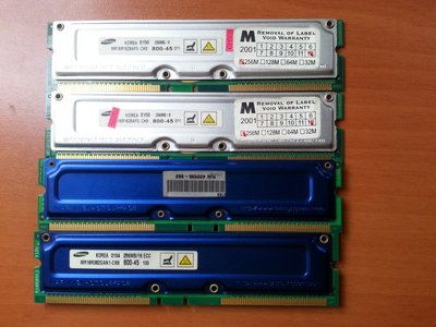

That Voodoo 3 3000 is great for the build, as the Samsung server memory is nice, but it need x4 of that memory, and it better to be 512MB modules (not sure if the BX chipset was supporting 512MB modules). Still if not supports 512 modules x4 of these will have 1GB of SDram that will be more then enough...
I have also PQI 256MB module (or was 128 not sure) the PCB is blue.....
You just find Gigabyte Blue IDE cables, also the Voodoo 3000 is not good for Tualatin, the FX5900 series will be better, also they are made from the 3Dfx engineers so is about the same...

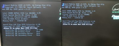

We have a small progress.
Moded bios from my friend partially works... It recognize CPU's at last so there is"Pentium III (Tualatin) @1,4GHz) and it runs every second / third time... so now I have to find a proper memory...
So it seems that running tualatin 1.4 on this motherboard will be possible 😀
I'll keep you updated

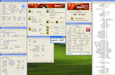

PS. Board does work with Tualatin on beta from 2002 :
654.53 KiB
352 views

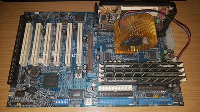

Here's how it looks :
1.23 MiB
352 views

That is also correct but it is not recognised ad Tualatin PIII and it does not work with full 1.4GHZ but "just" 1.05GHz - exactly as on your screen.
I managed to run it at 1.17GHz without any problem (FSB112)... but my goal is to run tualatin as it should be: 1.4GHz @fsb 133...

Also it will be nice if some of you upload picture only of the mobo itself, as i don`t have a single picture of it, there is none on the internet, at least not quality ones..

Reply 37 of 46, by Batyra
With a help from @Skyscraper (huge thanks to you!!!)
I manage to make PIII tualatin run @1.4 on this motherboard with Slot-T adapter!
It's alive!!!!
114.86 KiB
279 views
Tualatins on GA-BX2000+
Now time for benchmarks etc 😀
Thanks again!
