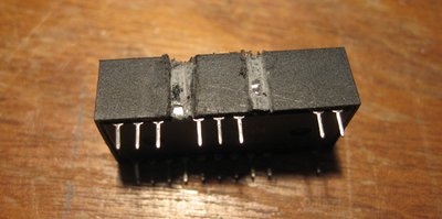

So I just moved on to a different computer in parallel with my longer term project (386) and so I checked all the hardware, set the non-PNP jumper stuff and powered it up to see what would happen. The BIOS settings were all wrong and I got a warning: "CMOS battery failed"
I've gotten this warning before... actually I got it on my 386 I just finished playing with but I fixed that a while back by yanking the crusty old ni-cd and replacing it with a Li-Ion battery. This board here... I can't find the battery! I looked everywhere and I can't find it. The board in question is a Shuttle HOT-557 board that looks like this:

Maybe I'm blind but I don't see a battery anywhere at all. Now what am I going to do? If there's no battery to replace I can't change my BIOS settings 🙁 This is going to present many problems. Could it be that they are using a capacitor instead of a battery?

That thing labelled DALLAS - That's where the battery is. You'll have to drill it out and replace it.

I've done this three times - Once I got lucky and the chip had a plastic cap on it.
I still managed to break the leg off the IC, good thing I have 40,000 hours of precise bodywork under my belt and 6/10 soldering skills (on a good day)
Other times, drill baby, drill!

I haven't looked recently but I think the DS12887A has generally been available on eBay. Of course some of them might be old.
If your chip is socketed then replacing it would surely be easier. If it's soldered then it's your call. If you decide to desolder it then at least install a socket, in case the replacement dies soon.
If you're not experienced with desoldering then it's usually safer to cut the pins off near the body of the chip, then you can desolder the pins one at a time. It's easier that way.
EDIT: I guess cutting the pins on a Dallas chip might not be that easy. I forgot how those things have such a bulky body that they cover the pins.
I suppose it *might* be possible to pull on the chip and see if it leaves the pins behind - but if that doesn't work you could cause serious board damage by ripping traces. So that's probably a bad idea.

I'd say it's 99% sure you will get one with a dead battery. I've bought several from different sellers, all DOA. The whole DIY fix is a very simple job, it will take around 5-10 minutes once you get going. Remember to test the current flow afterwards.

Digikey sells new ones, I would think mouser and other big name electronics distributers would as well.
for ~$10 each for a recent stock one from a reputable distributer isnt a bad price IMO. The last 5 that I bought last August were week 50 of 2016 (1650) datecode.
https://www.digikey.com/product-detail/en/max … 2887--ND/956874
If you remove the old one to solder one a new one, i highly reccomend getting one of these for each one you do:
https://www.digikey.com/product-detail/en/3m/ … 5467-ND/1133620
(Just trim off the leads from the socket that are not present on the Dallas chip.)
I usually replace them on older boards that I get a hold of, and keep the old ones that later I modify with a CR2032 holder as a backup.

Based on what I'm seeing so far, it looks like the easiest way to do this is just remove the MB from the case and dremel it in-place. Probably the most dangerous way to do it but then again it could also be dangerous to try to remove the chip from the board if you don't know how to do it properly like me. I've never desoldered anything with more than 2 legs before and I'm afraid to start on this piece of hardware.

Use a soldering wick or a suction gun. I've done DIPs with these tools and while it does take a while, it eventually gets done.
I'm actually eyeing a 486 board online for $3 with the exact issue you're having. Soldered on Dallas. I think I'm going to take up the challenge 😉

I’ve modded one of these without removing it from the motherboard and it’s was fiddly but possible:
It's 286 time!
I wouldn’t do it again though - as suggested by Jed118 I use wick now for desoldering. Just practice on something else for 15 mins first.
And yes these things are annoying but 100% better than a dead motherboard due to a battery that leaked.

That's quite a good repair. The 486 I'm bidding on now has that same problem, but the RTC is facing a resistor pack. I would have done it your way if I could.
