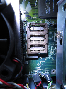

I received my SOJ sockets today. They are a bit larger than I had hoped. Originally I thought I'd only have to mill holes into the bottom of the socket to sit over the SMD ceramic and tantalum caps on the board, but it appears that the sockets are also too wide, even when placed side-by-side touching. So the touching side of the socket also needs to be run on a belt sander. Here's an image. I have layed 3 SOJ sockets on top of the SRAM chips. The socket on the top was placed directly centre on the SRAM module. Although it looks off centred in the photo because of the camera angle, I can assure you it is centred. I went to put the 4th socket on, but it fell off. So if we were to sand off 0.5 mm from each side, the sockets should fit.
188.21 KiB
105 views

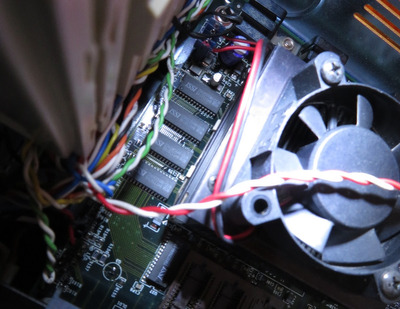

Then I got to looking at the placement of the other SRAM modules. It looks to me that if the sockets were soldered on that the CPU retaining clip would not be able to be installed. There's only so much of the socket which can be ground away before it becomes too flimsy.
195.73 KiB
105 views
