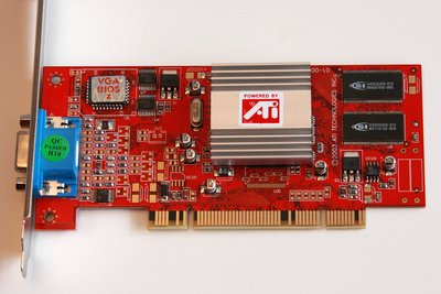

Reply 8 of 15, by Windman
Vlask,
Guess I was lucky I didn't brick a card when playing around with flashing fw...
I did try the CD that came with the cards and also the latest Rage 128 from ATI homepage.
Now I tested all drivers from the link you posted. No luck 🙁
lazibayer,
I took some pictures of one of the cards.
All 10pcs looks almost exactly the same. You can tell on the PCB there are different batches.
The layout on the PCB is identical. Some IC's have different s/n and so on...
Any more ideas?
Card seem to work fine when forcing Windows to accept a Rage 128 Pro driver.
It would of course be nice to have correct drivers, but don't know how much more time I want to spend on this.
If I where to invent all 10 cards. What info would be of use?

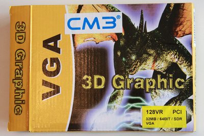

Reply 9 of 15, by lazibayer
It seems that these cards are not made by reputable manufacturers. The sticker on the box says 128VR and the sticker on the PCB says 128Pro, and they are definitely not All in Wonder 128 Pro. I worry if they put the right GPU and the right BIOS on the board....

Reply 12 of 15, by Windman
All 10 boxes have the exakt same driver CD with the same content.
One card installed as "Xpert 128" and another as "All-In-Wonder 128 PCI". And then there are cards that have different vendor ID's, so the drivers won't load.
I bought all the cards at the same time from a shady Ebay seller.
The price was €5 each. So can't really complain...
This is from the driver CD:
[Mfg]
;Retail
"Rage Fury Pro/Xpert 2000 Pro "= 128_AGP, PCI\VEN_1002&DEV_5046&SUBSYS_00081002
"Rage Fury Pro "= 128_AGP, PCI\VEN_1002&DEV_5046&SUBSYS_00041002
"Rage Fury Pro "= 128_AGP, PCI\VEN_1002&DEV_5046&SUBSYS_00141002
"Rage Fury Pro/Xpert 2000 Pro "= 128_AGP, PCI\VEN_1002&DEV_5046&SUBSYS_00181002
"Rage Fury Pro "= 128_AGP, PCI\VEN_1002&DEV_5046&SUBSYS_00481002
"Rage Fury Pro/Xpert 2000 Pro "= 128_AGP, PCI\VEN_1002&DEV_5446&SUBSYS_00081002
"Rage Fury Pro "= 128_AGP, PCI\VEN_1002&DEV_5446&SUBSYS_00041002
"Rage Fury "= 128_AGP, PCI\VEN_1002&DEV_5246&SUBSYS_00441002
"Rage Fury "= 128_AGP, PCI\VEN_1002&DEV_5246&SUBSYS_04481002
"Rage Fury/Xpert 128/Xpert 2000 "= 128_AGP, PCI\VEN_1002&DEV_5246&SUBSYS_00481002
"Magnum/Xpert 128/Xpert 99 "= 128_AGP, PCI\VEN_1002&DEV_5246&SUBSYS_00041002
"Magnum/Xpert128/X99/Xpert2000 "= 128_AGP, PCI\VEN_1002&DEV_5246&SUBSYS_00081002
"Xpert 99/Xpert 2000 "= 128_AGP, PCI\VEN_1002&DEV_524C&SUBSYS_00081002
"Xpert 99"= 128_AGP, PCI\VEN_1002&DEV_524C&SUBSYS_00881002
"Xpert 128"= 128_AGP, PCI\VEN_1002&DEV_534D&SUBSYS_00081002
"Xpert 2000 "= 128_AGP, PCI\VEN_1002&DEV_534D&SUBSYS_00181002
"Xpert 128 "= 128_PCI, PCI\VEN_1002&DEV_5245&SUBSYS_00081002
;AiW
"All-In-Wonder 128 Pro PCI"= 128_PCI, PCI\VEN_1002&DEV_5044&SUBSYS_00281002
"All-In-Wonder 128 Pro PCI "= 128_PCI, PCI\VEN_1002&DEV_5044&SUBSYS_00291002
"All-In-Wonder 128 Pro AGP "= 128_AGP, PCI\VEN_1002&DEV_5046&SUBSYS_00281002
"All-In-Wonder 128 Pro AGP "= 128_AGP, PCI\VEN_1002&DEV_5046&SUBSYS_002A1002
"All-In-Wonder 128 PCI "= 128_PCI, PCI\VEN_1002&DEV_5245&SUBSYS_00281002
"All-In-Wonder 128 PCI "= 128_PCI, PCI\VEN_1002&DEV_5245&SUBSYS_00291002
"All-In-Wonder 128 PCI "= 128_PCI, PCI\VEN_1002&DEV_5245&SUBSYS_00681002
"All-In-Wonder 128 AGP "= 128_AGP, PCI\VEN_1002&DEV_5246&SUBSYS_00281002
"All-In-Wonder 128 AGP "= 128_AGP, PCI\VEN_1002&DEV_5246&SUBSYS_00681002
"All-In-Wonder 128 Pro Ultra AGP"= 128_AGP, PCI\VEN_1002&DEV_5446&SUBSYS_002A1002
"All-In-Wonder 128 Pro Ultra PCI "= 128_AGP, PCI\VEN_1002&DEV_5446&SUBSYS_002B1002
"All-In-Wonder 128 Pro Ultra AGP "= 128_AGP, PCI\VEN_1002&DEV_5446&SUBSYS_00281002
"All-In-Wonder 128 Pro Ultra PCI "= 128_AGP, PCI\VEN_1002&DEV_5446&SUBSYS_00291002
Can I just edit these rows and add the vendor ID for each card? Will the drivers be accepted after that?
How does Win98 react to broken WHQL certification?
Reply 13 of 15, by Windman
I will reply to some of my own questions 😀
I added a line with the correct Vendor ID/Device ID in the .inf file.
Win98 loaded the drivers without any complaints at all.
This will be my solution:
Collect the device ID from all 10 cards and add a line for each of them in the .inf file. Giving me a driver package that will work with all the cards.
Thanks all for your help!
Reply 14 of 15, by meljor
found some older divers here:
http://www.helpjet.net/Pi-19024625.html
Reply 15 of 15, by lazibayer
Windman wrote:
I will reply to some of my own questions :) […]
You are welcome! If all your cards have the same vendor/device ID and only differ in the subsys ID you can just write a "superclass" string to include them all. For example,
"Rage 128 PCI" = 128_AGP, PCI\VEN_1002&DEV_5452
It will match all cards regardless of the subsys ID.
Just FYI 128 Pro is one generation newer than 128. The pro version supports 4x AGP instead of 2x, but it doesn't make a difference for being in PCI version. Officiallytt the pro version has faster triangle setup engine, faster core and memory speed, but it's also subject to the settings in the video BIOS. You can use some tools such as GPU-Z and Sandra to find out what's the chip under the hood if you want to.
