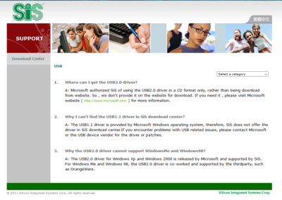

Reply 2 of 3, by fitzpatr
My first checks would be :
Download SiS Chipset drivers for your board.
Install windows 98 USB driver pack nusb36.exe Google them. (If you're still running Windows 98)
Confirm that the BIOS is set up in the Integrated Peripherals section. (Double Check)
EDIT:
It looks like you'll need to get one of the Driver Packages here:
https://list.driverguide.com/list/company4007/index.html
Refer to this site for more information:
http://w3.sis.com/support/support_faqs_15.htm
    252.17 KiB
    381 views
    SiS USB Drivers Information
