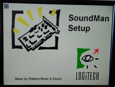

-I used the original Logitech installation files as a starting point. These are available at https://www.driverguide.com/driver/detail.php?driverid=12895 (The description says Windows 95, but this package contains DOS and Win 3.1 drivers). I did this because I was curious how much customization Logitech did and there isn't a lot of information out there about the Logitech software that originally came with the card.
-No complaints about the installer. It is friendly enough and will guide you through the DOS and Windows 3.1 portions of install.

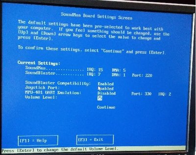

-By default the PAS16 side of the card will be configured with IRQ 15 / DMA 5 and the SB card with IRQ 7/ DMA 1 / Port 220. I changed the PAS16 IRQ to 7 and SB IRQ to 5 as my reading indicated this is a more common configuration.
