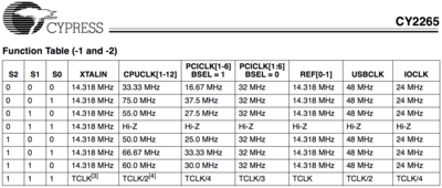

It seems that the board has 3 jumpers (JP1, 2, 3) for bus speed but only 5 out of 8 combinations are documented on stason's. There is a small chance that the board has undocumented 83MHz bus speed. I can try to look up the datasheets if you can provide me the model number of the clock generator chip.
I think this is the name: CY2265PVC-1
it's nearly a 14.3 crystal.

Unfortunately it can only go up to 75MHz.
Reply 14 of 15, by weldum
didn't expect much on this board though. i'll keep it at 75x3=225Mhz
