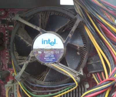

Reply 3 of 28, by bandicoot67
Good on you for keeping the old PC alive! I get scared taking stuff apart sometimes too, specially if the thing is working ok, but every now n then you have to go for broke. Dismantle every thing, clean it all and re-assemble it. Takes a long time. Some of the PC's ive found thrown out have been horrific to even look at. Honestly, i don't understand how anyone could expect a computer to work properly like this.
***WARNING-EXTREME GRAPHIC CONTENT***
    814.36 KiB
    1756 views
Reply 4 of 28, by Scubs
That's nothing.
