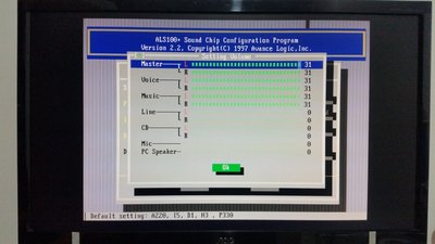

The hiss and volume problem is because of wrong mixer settings when initializing the card in DOS, my card has very low noise floor and proper line-out signal strength so everything is okay related to that.
The wrong balance between SB and FM can be tweaked in the mixer, but some games reset the mixer when entering or exiting the game, yet some other games completely take control over the mixer.

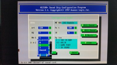

16bit games in DOS will not use 16bit because the High DMA is not defaulted to 5 which most if not all games use.
I could not set Duke3D or any other 16bit game to use 16bit sound because of that.
Maybe I have DMA 5 taken by other hardware and ALS100+ setup will not show DMA that is already in use but I doubt that it's that smart.

There's actually no relation between 16-bit sample playback and the ability to choose a high DMA channel. It's like saying that an 8-bit VGA card can not display a 16-bit screen mode or a 386sx can not run 32-bit software...
The difference between low and high DMA channels is just bandwidth. A low DMA channel can only transfer a single byte per cycle, a high DMA channel can transfer 2 bytes per cycle (by using both DMA controllers, afaik). Whether the data is 8 bit, 16 bit, or 32 bit doesn't matter. So why decided Creative to use one low and one high DMA channel with the SB16? Simply because on a PC, you only have two low DMA channels free at all, so it would leave you with no options.
Anyway, the ALS100+ plays 16-bit samples just fine using a low DMA channel, as long as the software allows choosing a low DMA channel for 16-bit. Most games adhere to Creative's way to use low DMA for 8-bit and high DMA for 16-bit, but not all do. In BUILD games, you can also overwrite the setting by editing the .cfg file.
ps: the later ViBRA cards default to a low-DMA for 16 bit as well.
