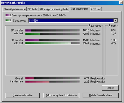

Reply 14 of 20, by ahtoh
I suspect the issue might be due to the bus transfer rate being too low. I tested it with Final reality and it says Bus transfer rate is 16 Mb/s
SiS 530 IGP scores 42 Mb/s in the same test
See attached:
16.11 KiB
1405 views
Voodoo3 PCI vs SiS 530 IGP
Any idea what could be the cause of this?

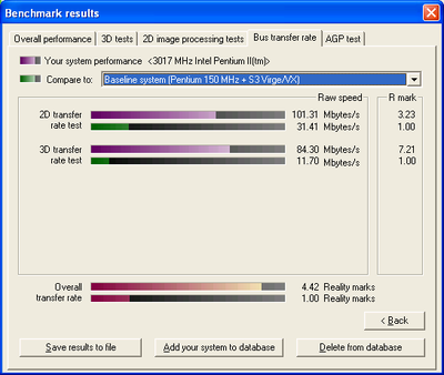

Reply 16 of 20, by ahtoh
That's because I don't have Voodoo 2, and I would need two to play unreal I think (my primary goal)
I'm also considering changing the motherboard, but not sure there are other SS7 mATX motherboards, and they are probably also based on this SiS 530 chipset.
p.s. I checked the Voodoo3 bus transfer rate on relatively modern PC and it is around 100 Mb/s:
