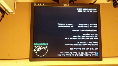

Thought I'd close out this thread on a positive note. After numerous issues ended up putting the SE440BX-2 aside and bought a Asus P3B-F rev. 1.04 board (expensive!!!) which at this point things are looking up! Thanks to all who chipped in on this post and others for the tips on trying to get the intel board running.

    Now if I can just fix my tendency to post pics from phone upside down!
