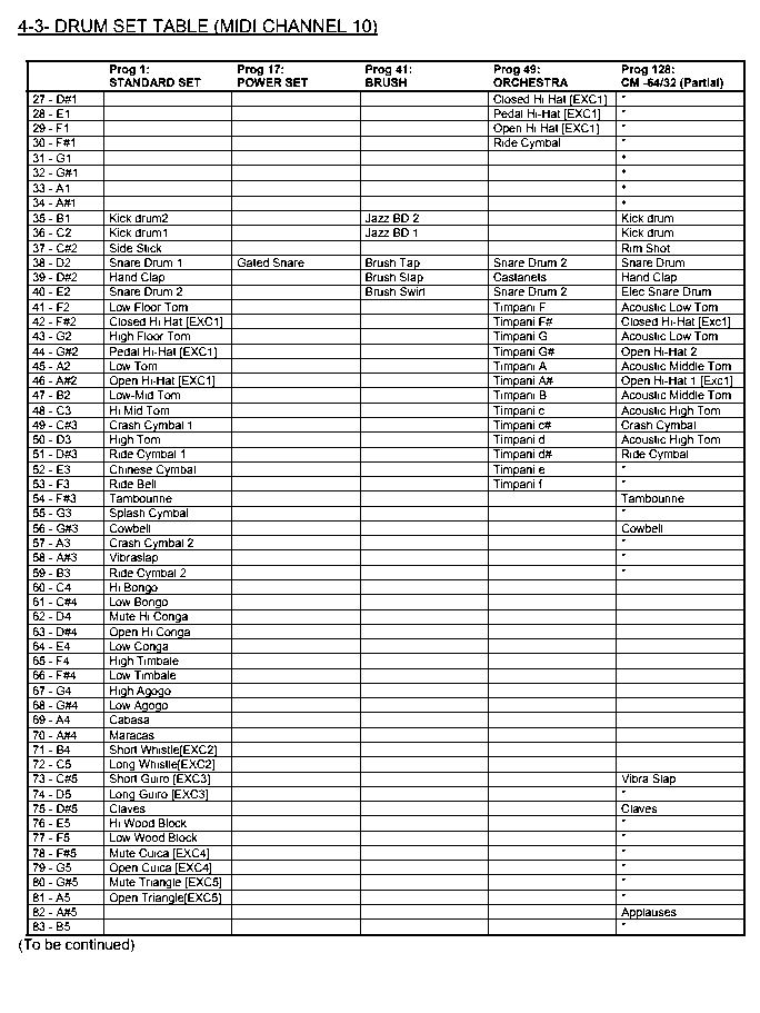

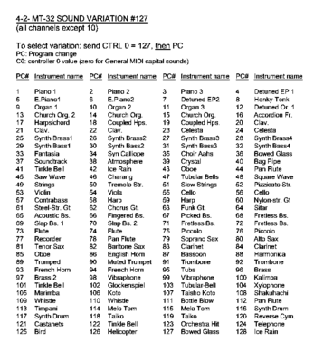

Reply 6 of 32, by dreamblaster
For DreamBlaster S2P, scali has been working on softMPU changes : allowing to use S2P in MT32 compatibility modus.
This is not a complete MT-32 implementation, but rather a mapping of the default tones. Still it can produce good results in some cases
We were planning to test this same change, for using DreamBlaster S1 an S2, through SOFTMPU

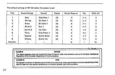

Reply 18 of 32, by Falcosoft
Scali wrote:
That would make more sense, but my tests with the S2P didn't seem to support this behaviour.
My first implementation would just send the CC 0, 127 to all MIDI channels at startup, but that didn't work.
Instead of sending only the Bank Select MSB messages maybe you can try to send the Bank Select MSB 127 + Default Program Change messages together. Unlike GM devices the MT-32 has different default programs on each channel after a reset. Some midis even could rely on these default programs, so even if it does not work as a final solution for MT-32 switch on melodic channels it would be a better starting/post-reset state.
127.57 KiB
1530 views
Unfortunately the document does not list the corresponding program numbers, so here they are:
68, 48, 95, 78, 41, 3, 110, 122, (127 drum)

Reply 19 of 32, by Scali
Okay, thanks... That is something that really should be in the emulation routine: initialize all channels to the MT-32 default.
I will do some more testing to see if they 'stick' after all...
But this means that the MT-32 by default only listens to channels 2, 3, 4, 5, 6, 7, 8, 9 and 10.
So channels 1 and 11-16 would still need to be switched to MT-32 mode, if they are used (I suppose there are SysEx commands that could change the channel mapping of the parts on a real MT-32, so it could use these channels in theory).
If the setting 'sticks', then I could at least switch them to program 1, so I can force MT-32 mode.
In that case it only won't work if there are indeed SysEx commands being sent to change the MIDI channel of a part, but there is no program change (so the new MIDI channel effectively 'inherits' the program of the previous channel).
If that turns out to be the case, then there should be a simple interpreter for SysEx commands, to work around this.
If the settings really don't 'stick', then I need to retain the current solution of prefixing it at every program change at runtime.
Edit: did another test, and indeed, the setting does not 'stick', so every program change must be preceded by the CC 0, 127 to select an MT-32 bank instead of the default.
I will add the standard initialization to the custom SoftMPU though.
